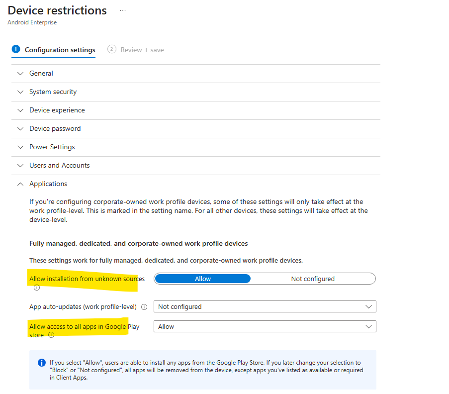

    @Qadir Hussain Thanks for posting in our Q&A. From your description, did you mean that you can't install apps from unknown sources both in personal profile and corporate profile? If there is anything misunderstanding, please correct me.
    To clarify this issue, we appreciate your help to collect some information:
    1.Which enrollment method did you use to enroll this device?
    2.Please check if you configure a device restriction policy for this device. Based on my research, there is a setting called "Allow installation from unknown sources".
    https://learn.microsoft.com/en-us/mem/intune/configuration/device-restrictions-android-for-work#applications
