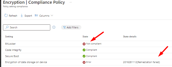

I have a device managed via Intune and silent BitLocker encryption is the only thing showing as non-compliant.

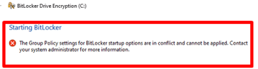

In review the device, BitLocker encryption has failed, i see it throws out this prompt:

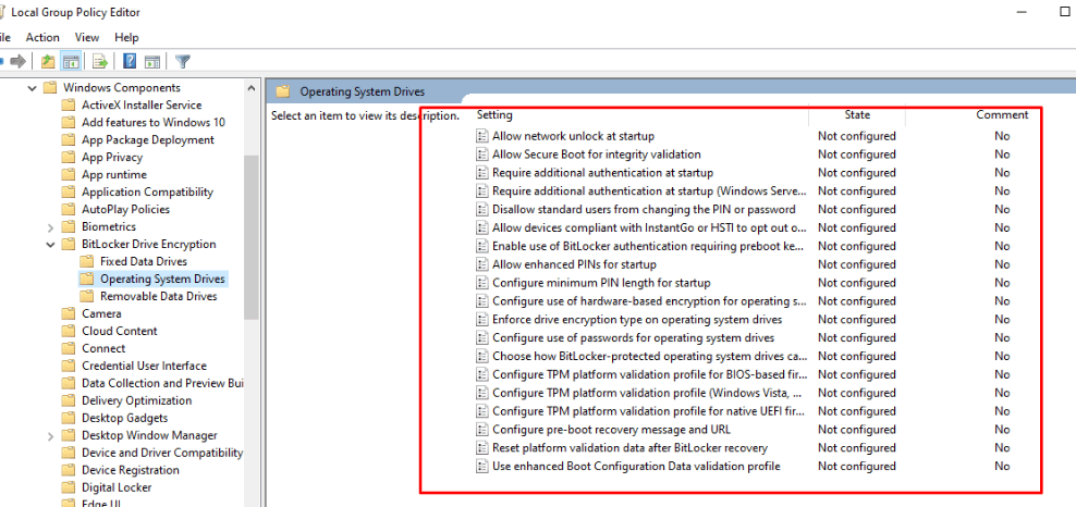

I went through the device local GP settings and all settings are as they should be per below:

Event ID: 851 Failed to enable Silent Encryption. Error: The Group Policy settings for BitLocker startup options are in conflict and cannot be applied. Contact your system administrator for more information..

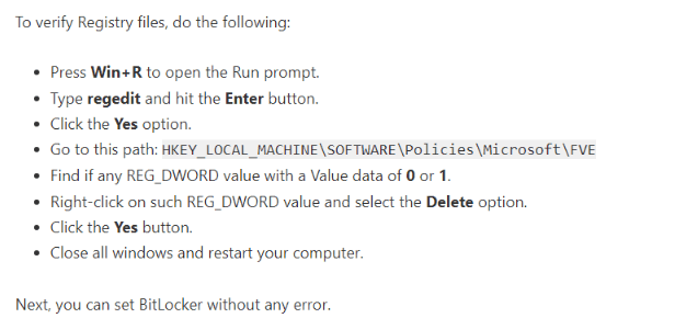

I have seen one online documentation advising to go into RegEdit and change any value data of 0 or 1 and delete these entries. Is this really the only fix or could it break the policies. What about any value with 2?

    @Juan, Thanks for posting in Q&A. From your description, I know the device shows non compliant because of BitLocker not enabled. And when we check on the device, it shows there's conflict group policy setting with BitLocker. But when we check the local group policy, we find it is not set there. Please confirm if there's any domain group policy applied to this device. If yes, remove the policy from this device to avoid conflict.

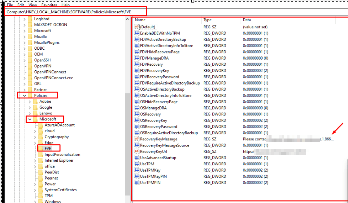

    In General, settings in the policy provider registry key will be duplicated into the main BitLocker registry key under HKEY_LOCAL_MACHINE\SOFTWARE\Policies\Microsoft\FVE
    https://learn.microsoft.com/en-us/troubleshoot/mem/intune/device-protection/troubleshoot-bitlocker-policies#bitlocker-registry-key
    If there's mismatch, it will cause issue, we can consider remove these mismatch registry key. To ensure nothing affect, you can backup the registry key before we remove it.
    Please try the above suggestion and if there's any update, feel free to let us know.

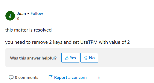

  2. Juan 0 Reputation points
    2024-08-01T23:21:09.1633333+00:00
    this matter is resolved
    you need to remove 2 keys and set UseTPM with value of 2
