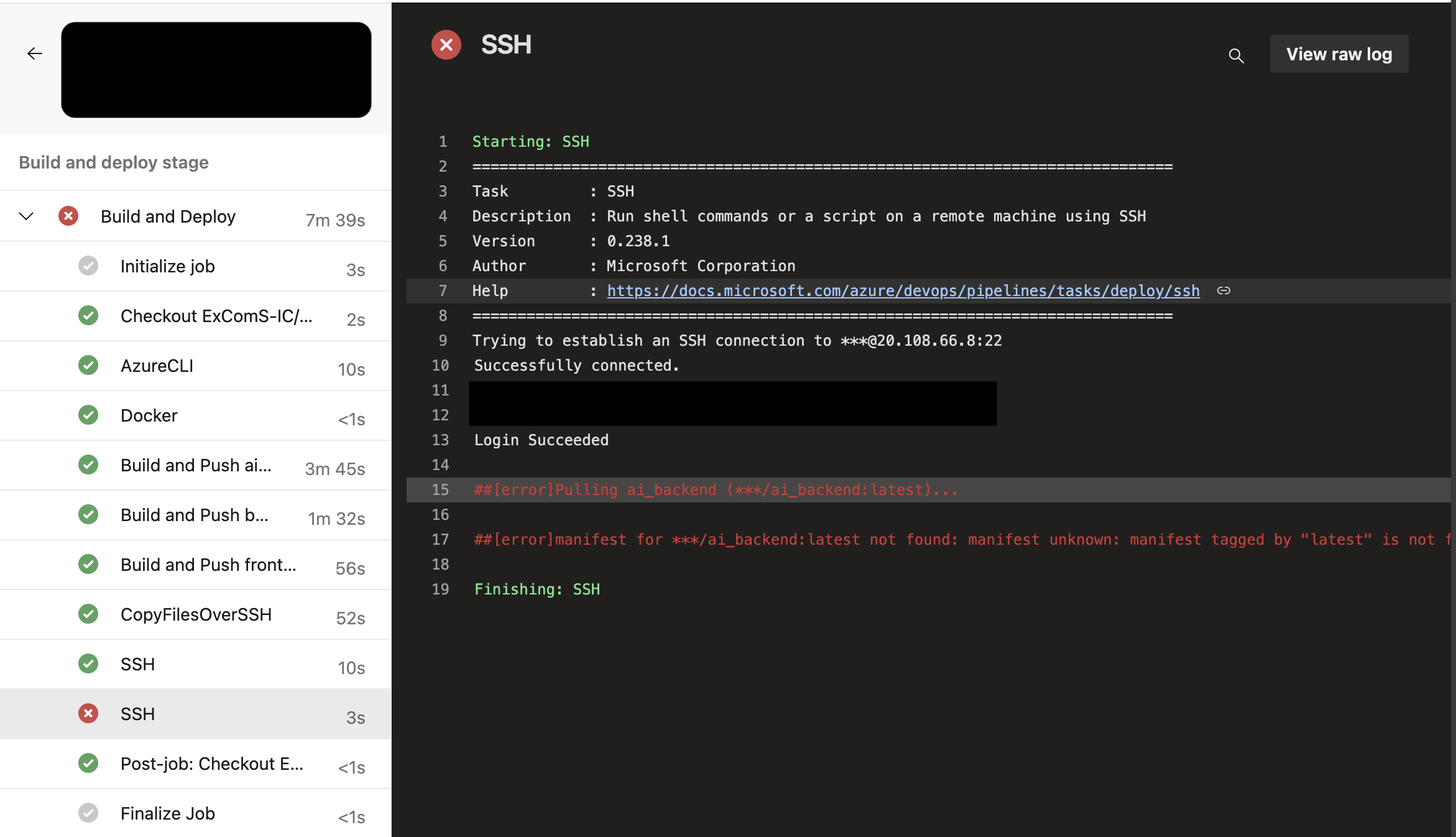

Hello,
I'm setting up a CI/CD pipeline using Azure DevOps, a Virtual Machine (VM) on Azure, and Azure Container Registry (ACR). My project uses Docker Compose and Traefik as a reverse proxy. Due to specific requirements, I'm using a VM instead of a managed service.
However, I'm encountering an issue where my VM isn't pulling images from ACR correctly. It seems like there might be a problem with the image tags or the way the images are being referenced.
Here’s the error I’m receiving:
2024-08-14T10:40:44.7501592Z ##[error]Pulling ai_backend (***/ai_backend:latest)...
2024-08-14T10:40:44.9192452Z ##[error]manifest for ***/ai_backend:latest not found: manifest unknown: manifest tagged by "latest" is not found
2024-08-14T10:40:45.0897108Z ##[section]Finishing: SSH
It looks like the 'latest' tag might not be found, but I'm not sure if this is a configuration issue with the VM, ACR, or the CI/CD pipeline itself.
Has anyone encountered a similar issue or can provide guidance on what might be going wrong?

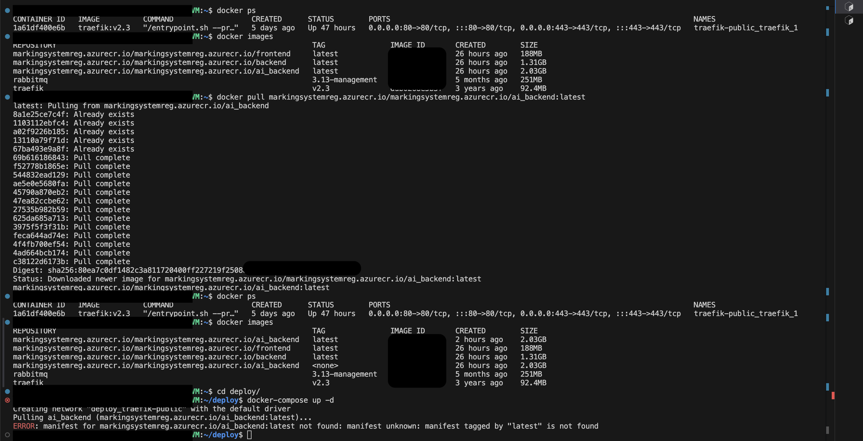

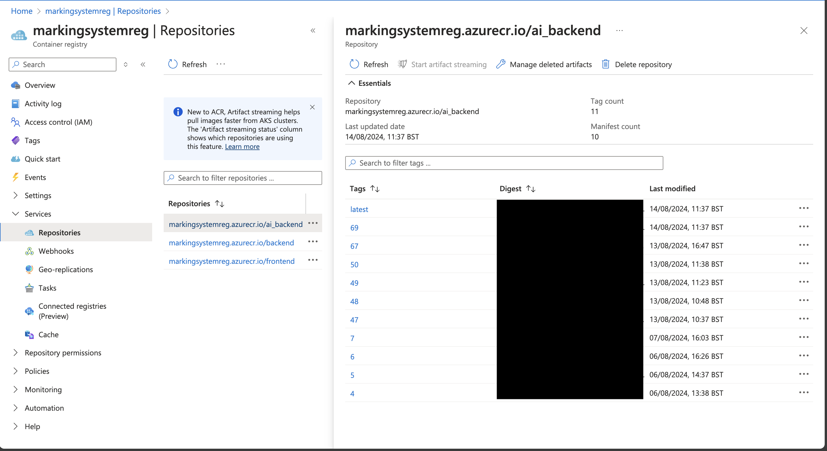

Screenshot 2024-08-14 at 11.44.32 Screenshot 2024-08-14 at 11.45.38Screenshot 2024-08-14 at 13.48.05
As you can see from the screenshot when I initially listed the available images, it displayed ones that were created 26 hours ago.
Next, I manually pulled the ai_backend Docker image, which had actually been updated two hours ago with Azure DevOps. Once manual pull process finished, I listed images again and it showed as being created two hours ago. This suggests that I may not be pulling the images properly.
Additionally, even when I tried running docker-compose manually on the VM, I still encountered the same error.
