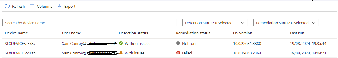

Intune reports the scripts as run, but the code is not being run properly, for example at the start its creating a new C:\TEMP folder, but this failed to get created, even when it does not exist.
If I run the scripts manually on the client, then they work correctly.

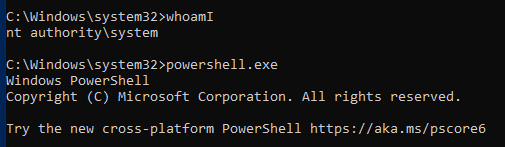

    Meanwhile, for script testing manually on the device, to test it under system account, we need to use PsExec tool to let it run under system account because environment variable is different when run under different account. Please confirm if we use PsExec.

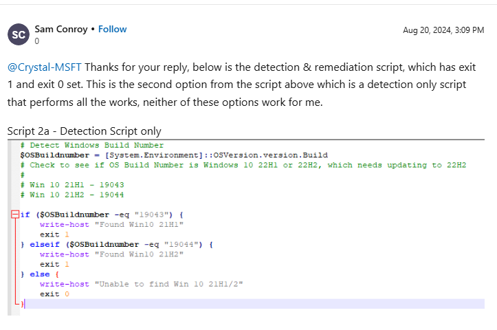

  2. Sam Conroy 20 Reputation points
    2024-08-20T07:09:58.92+00:00

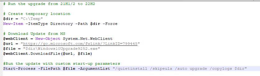

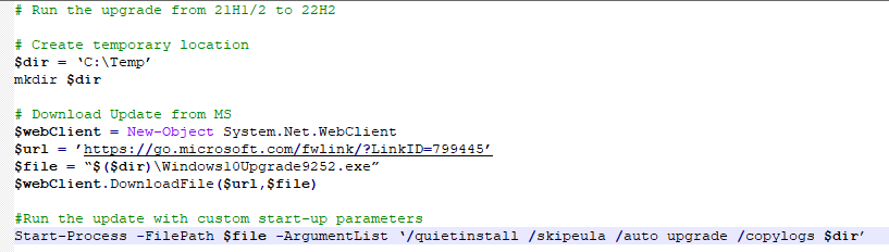

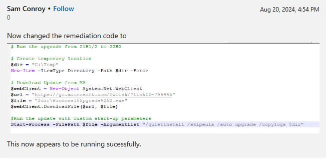

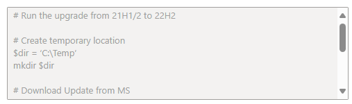

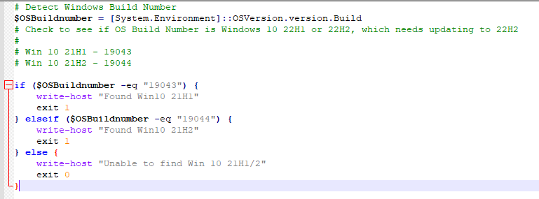

    @Crystal-MSFT Thanks for your reply, below is the detection & remediation script, which has exit 1 and exit 0 set. This is the second option from the script above which is a detection only script that performs all the works, neither of these options work for me.
    Script 2a - Detection Script only
    Script 2b - Remediation Script Only
    When I have been testing the PS scripts manually, no I have not been using PSExec, I have been manually running the PS script on the endpoint computer.
