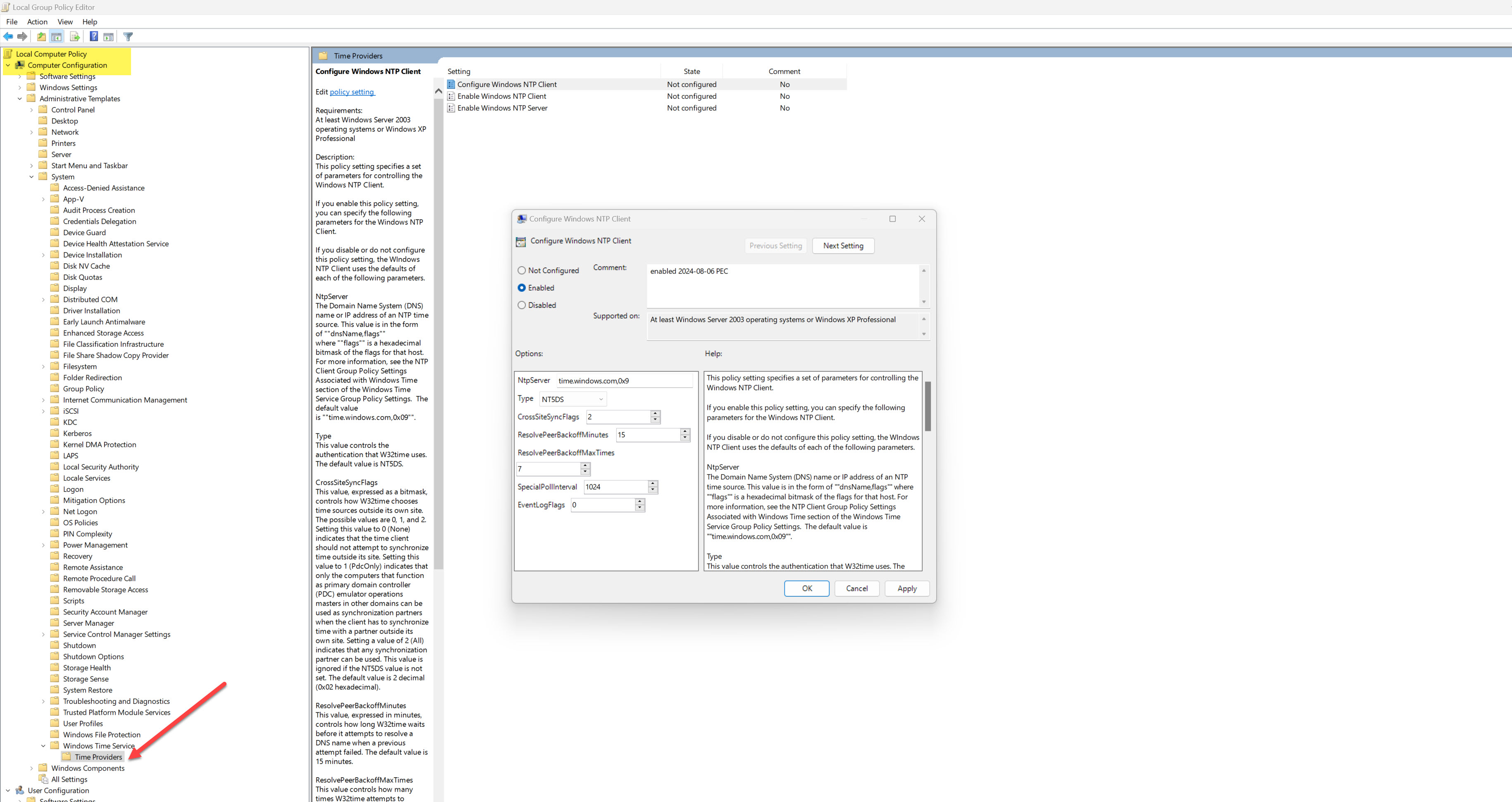

When I use GPEDIT.MSC and create the policy (using all the defaults) for NTP the computer no longer updates the time automatically. If I try to use the Sync Now button, it gives an error.
Specifically, in Local Group Policy Editor I go to Local Computer Policy > Computer Configuration > Administrative Templates > System >Windows Time Service > Time Providers.
I then Enable Configure Windows NTP Client using all the defaults.
NtpServer: time.windows.com,0x9
Type: NT5DS
CrossSiteSyncFlages: 2
ResolvePeerBackoff/Minutes: 15
ResolvePeerBackoff/MaxTimes: 7
SpecialPollInterval: 1024
EventLogFlags: 0
2024-08-06_14-34-36 Local Group Policy Administrative Template

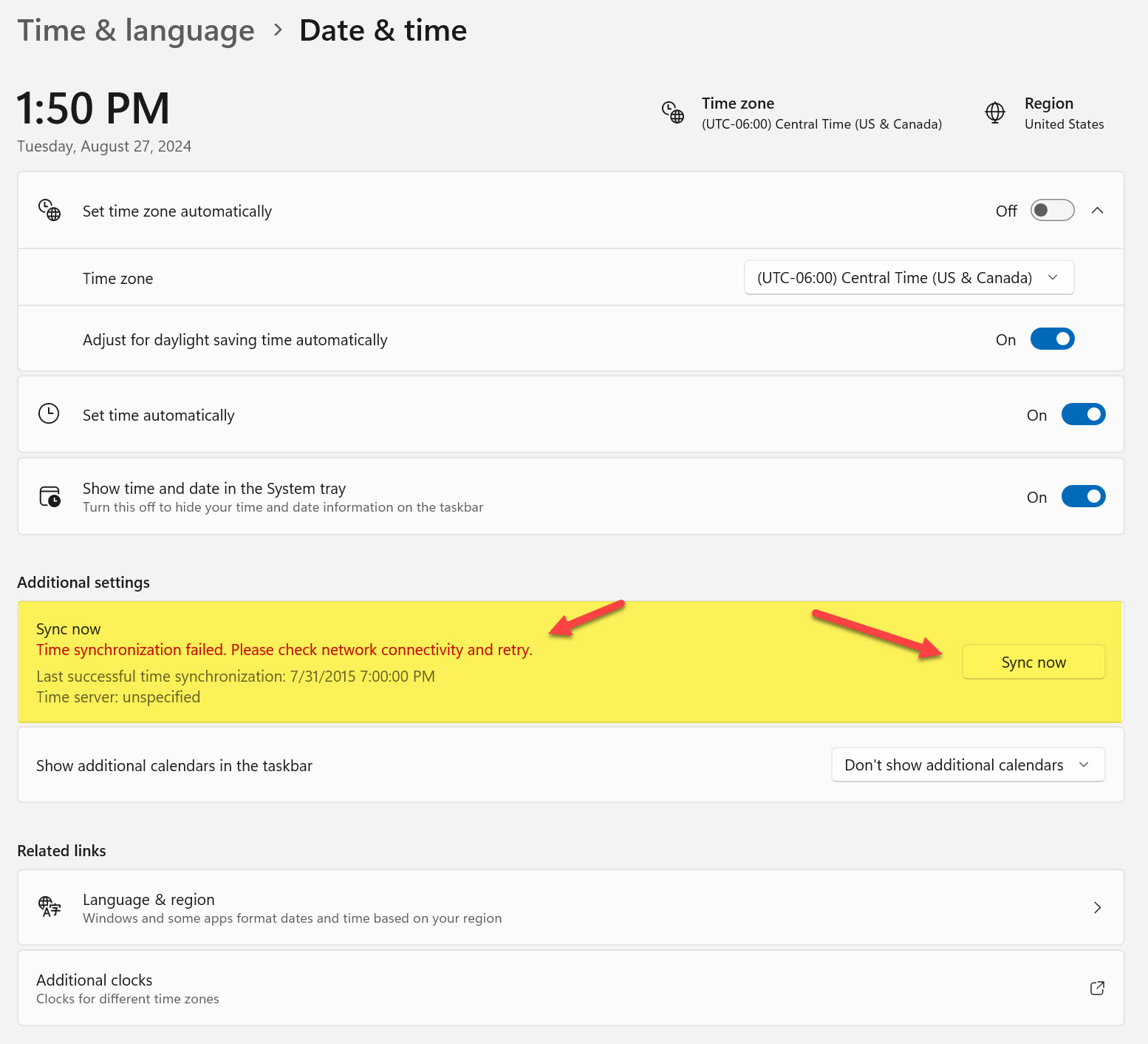

If I then go to Date and Time Settings and Sync Now, it gives an error: Time synchronization failed. Please check network connectivity and retry.
2024-08-27_13-51-06 Time Synch failed

    @Paul Chasnoff, Thanks for posting in Q&A. From the error message, it shows the synchronization failed. After checking the configuration, I find the type is set as NT5DS. For this type, it means that they synchronize time from the domain hierarchy. You can see more details in the following link:
    https://learn.microsoft.com/en-us/windows-server/networking/windows-time-service/windows-time-service-tools-and-settings?tabs=config
    But in our scenario, we sync from external NTP server. Please change Type to NTP to see if it can work. Meanwhile, we can also add more NTP servers to avoid any issue with NTP server. Here is a link with the example of the configuration for your reference.
