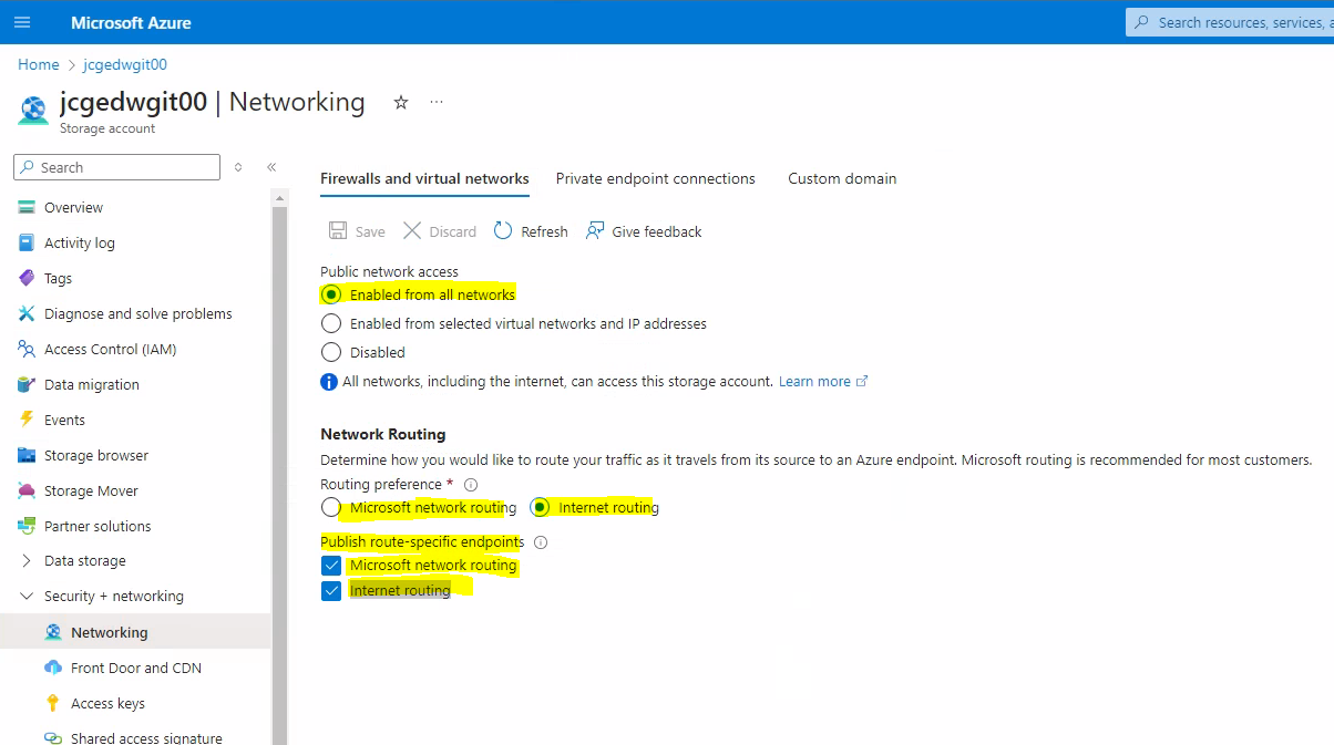

    3. Yes, that is my understanding that ARM needs to use the public internet. Note, I tried both "Microsoft network routing" and "Internet routing" which neither worked. I also checked the boxes for "Microsoft network routing" and "Internet routing" under "Publish route-specific endpoints" and that didn't work either. See the screenshot below.

    1. I just created the storage account using all the defaults. There are no specific IP addresses blocked. The default firewall is enabled as shown in the screenshot below.
    2. Anonymous access to the storage account is disabled. But I do believe Public access is enabled. And we're not using private end-points.
    3. I tried all the different options highlighted in the screenshot below. I tried both "Microsoft network routing" and "Internet routing". Also, I checked the boxes for "Microsoft network routing" and "Internet routing". This did not make a difference.

    Here's the screenshot:
