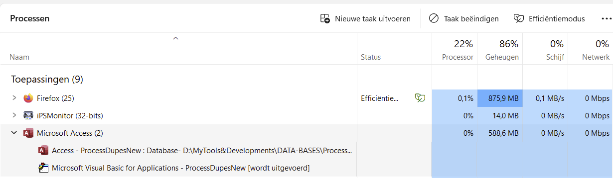

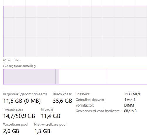

  2. louis1-6497 0 Reputation points
    2024-09-07T14:20:42.3566667+00:00
    I did copy some lines from the reaction and below each line a comment
    *Resource Contention: Running multiple shell processes in parallel can lead to resource contention, especially if each process is resource intensive. Ensure that your system has sufficient CPU and memory resources available.*
    The PC is an 8 core 16 threads CPU. 32GB RAM. I have no reason at all to assume there is lack of resources. Monitoring with the task manager only shows that CPU memory and disk are far from fully used.
    Process Management: Your program waits for earlier shell processes to finish before starting new ones. If these processes are not terminating correctly or are taking longer than expected, it could cause delays. Consider adding more robust error handling and logging to track the status and duration of each shell process.
    I have implement a scheduler which monitors all started processes, and do not start new one's before others have finished. Apart from that in a lot of cases the problem is already there when starting the first shell program.
    If a program is not ready withing the expected time, the main program kills the program using ^kill^
    Dim PScmd As String
    PScmd = "Stop-Process -ID " & CStr(ProcessID) & " -Force"
    Call PS_Execute(PScmd)
    I also check if the program is correctly started by verifying that the PID <> 0
    the Shell function runs asynchronously by default, which means the next line of code executes immediately. Ensure that your code correctly handles asynchronous execution.
    asynchronously is one of the two main reason to use this principle ! :) The other reason is that I need to use external programs. I have no reason to believe that those programs do not behave correctly. As described the behavoir starts correct .... or not ... and functions well for hundreds of times before lets say 15 ms changes suddenly into 3.5 seconds.
