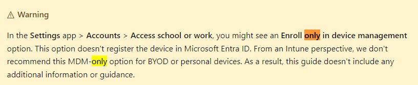

    For Enroll only in device management option. This option doesn't register the device in Microsoft Entra ID. From an Intune perspective, we don't recommend this MDM-only option for BYOD or personal devices. Also this is not for corporate device either. For your scenario, although the device has Microsoft Entra Hybrid joined device recorded, this record will not associate with the Intune records.
    Meanwhile, for app deployment, some apps have requirements for example, win32 app needs the device enroll into Intune and also it needs to be Microsoft Entra registered, Microsoft Entra joined or Microsoft Entra hybrid joined. For Enroll only in device management option, it will not create Microsoft Entra device record to associate. So it may fail.
    https://learn.microsoft.com/en-us/mem/intune/apps/apps-win32-app-management#prerequisites
    For your scenario, please change another enrollment method instead of Enroll only in device management option for these devices.
