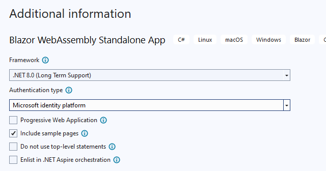

    Now we have an Api which demanding correct access token in request header to get the correct response. Let's continue to create a new blazor web assembly project by VS template, and choose the same authentication type.
    You will see codes below in Program.cs which using MSAL library.
