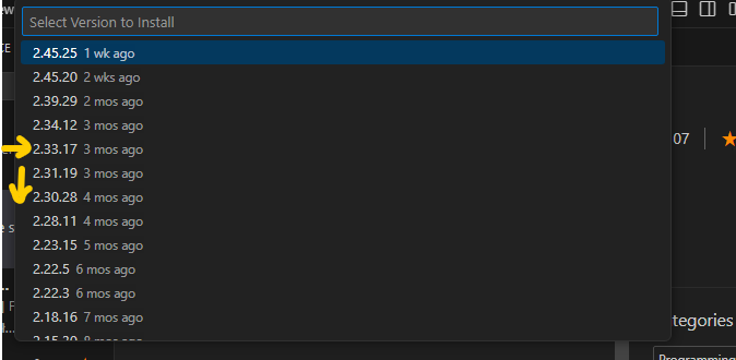

    Please kindly refer to this ticket: [macOS 11 x64] Cannot compile or debug with VSCode for C# Program:
    The issue is that the debugger now builds on macOS 12 machines as macOS 11 is deprecated for Azure Pipeline Build Agents. See https://learn.microsoft.com/en-us/azure/devops/pipelines/agents/hosted?view=azure-devops&tabs=yaml#software
    The workaround would be to use an older version of the C# Extension starting from v2.33.17 or before or update your macOS to macOS 12.
    Also .NET 8 only supports macOS 12+ …

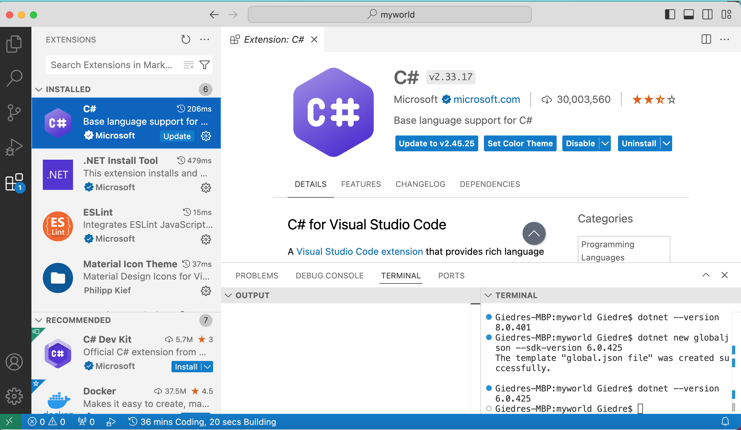

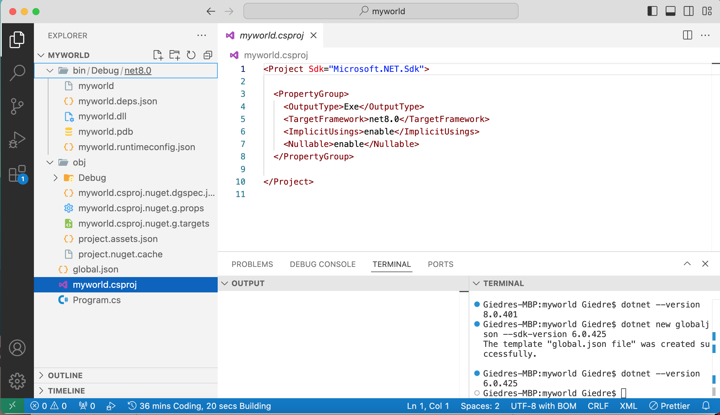

  1. G 20 Reputation points
    2024-10-22T10:19:43.0933333+00:00
    Hi @Tianyu Sun-MSFT again. I hope you are well!

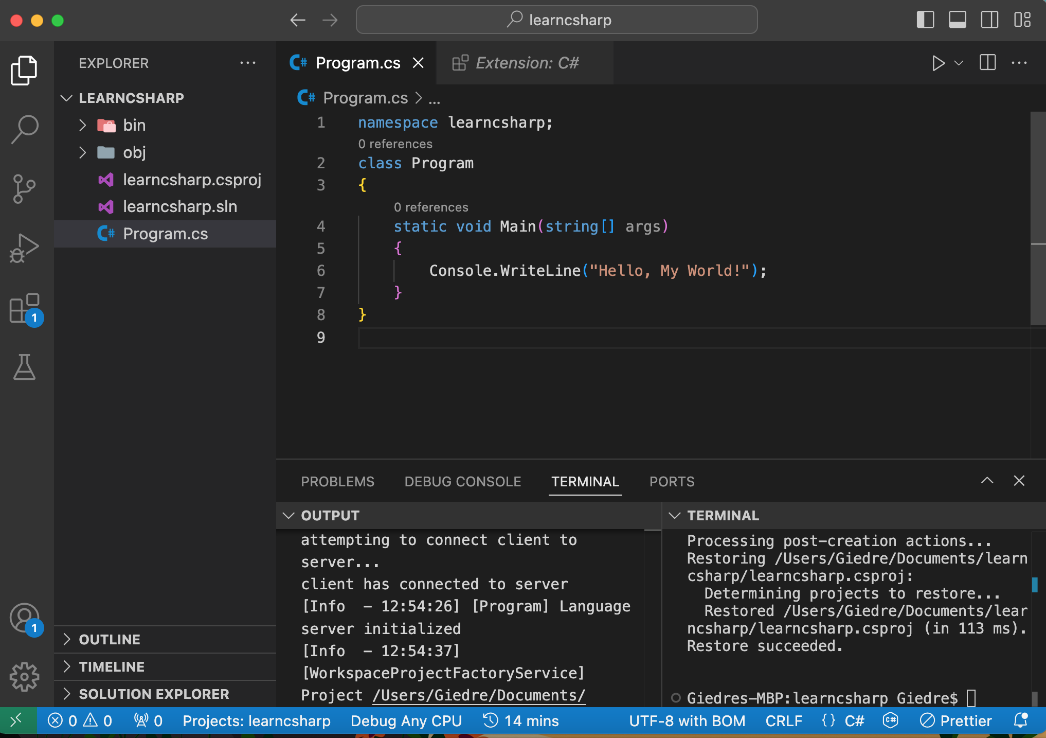

    Last time somehow I managed to create an application and it works. I want to make a new one. I cannot get launch.json and task.json files. I am doing as says in here https://learn.microsoft.com/en-us/dotnet/core/tutorials/with-visual-studio-code?pivots=dotnet-6-0#run-the-app-2.
    This is how it looks on the step 6:
    Screenshot 2024-10-22 at 13.09.39

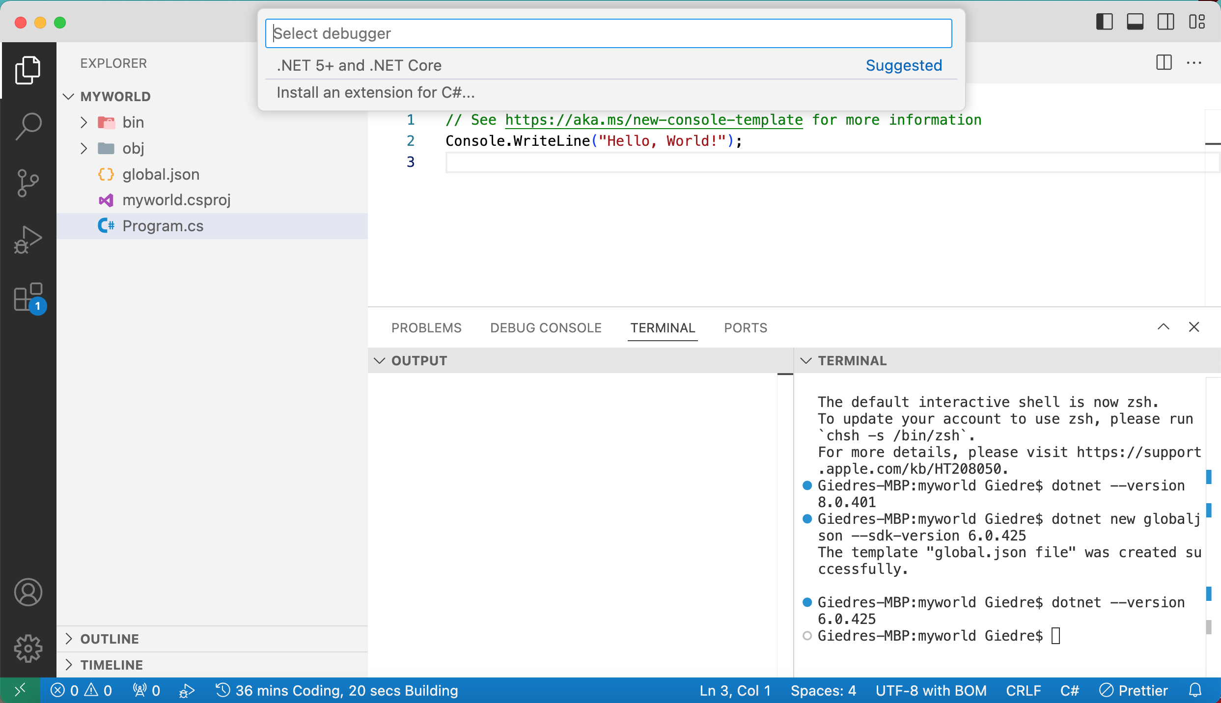

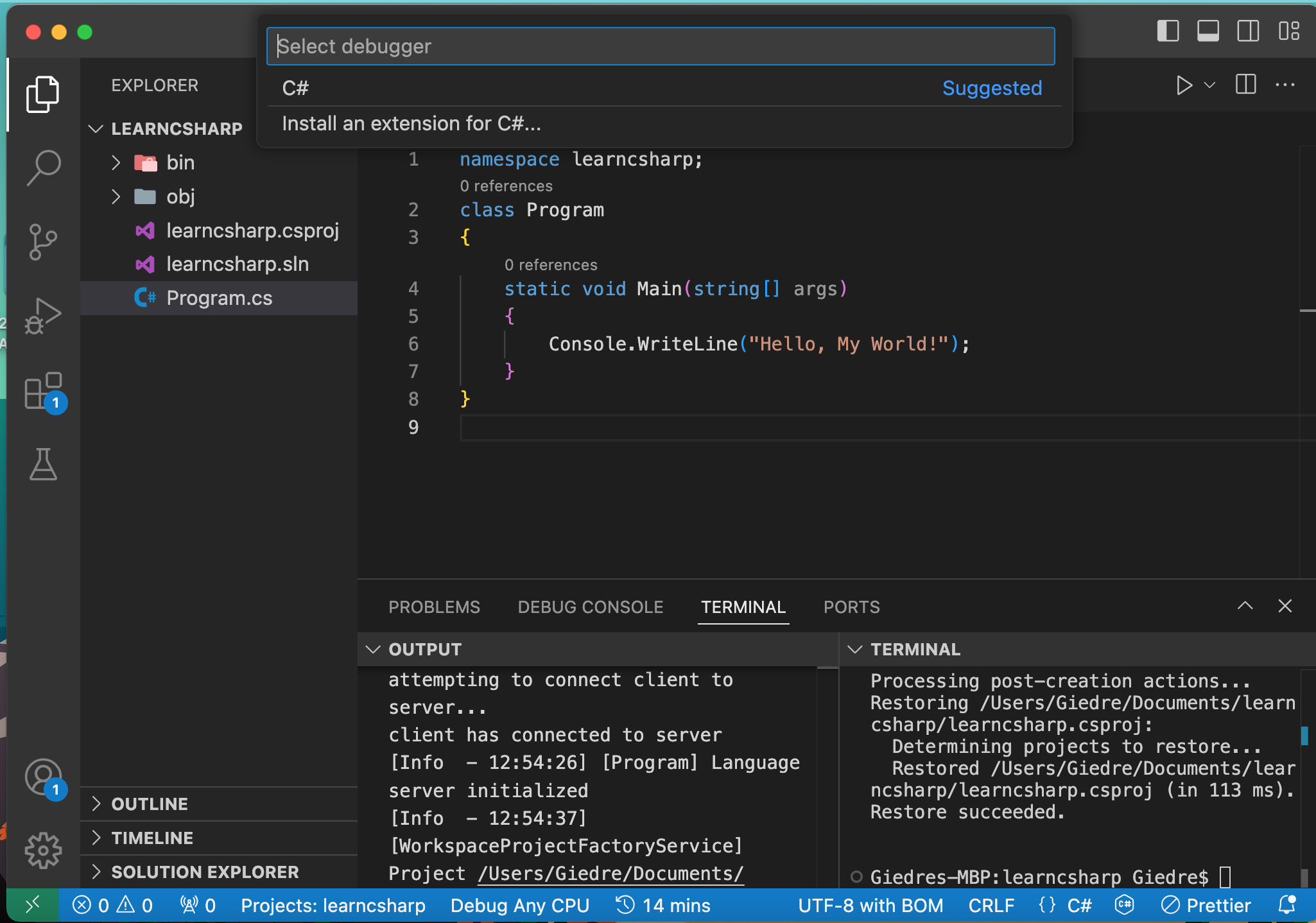

    When I try to do this "If you don't get the prompt, or if you accidentally dismiss it without selecting Yes, do the following steps to create launch.json and tasks.json:
    • Select Run > Add Configuration from the menu.
    • Select .NET 5+ and .NET Core at the Select environment prompt.". But I can only see C#:
    Screenshot 2024-10-22 at 13.09.56
    What's missing..?
    Thank you.
