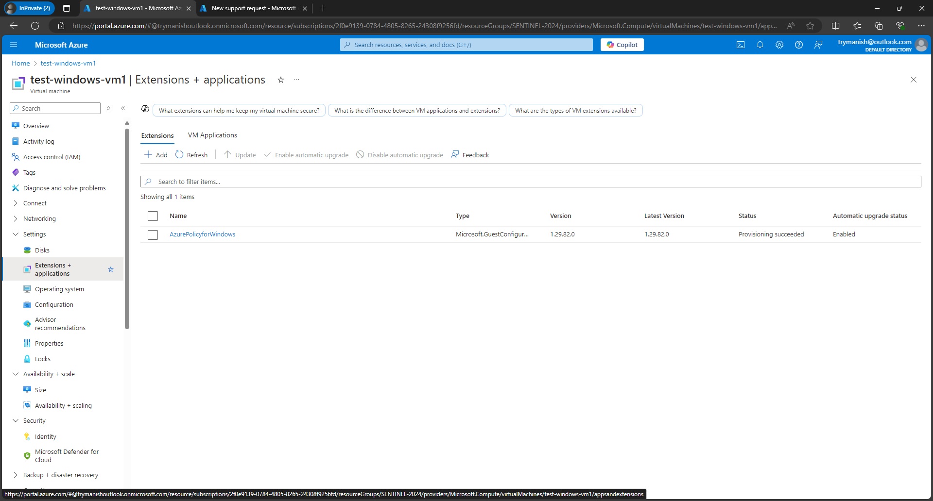

azure-sentinel-log-unavailable-for-windows-VM-1.jpgAzure Windows VM login related logs not getting ingested in MS SENTINEL logs.
I have created a VM (windows 10) and trying to do successful and failed login attemps, but I am unable to see the related logs in MS SENTINEL. I do see extentions as attached. Also I have enabled few things in the VM, so that it can start to send the audit logs, but I can do a screenshare to see what else is missing to be configured.

    -- VM is not connected to the "Log Analytics" -- The monitoring agent was not active in the windows VM. -- Then in the Content Hub -- Data Connectors -- added "Windows Security Events", and then selected 2 for install "Security Events Via Legacy Agent" and "Windows security events via AMA". -- Now, disconnect and once again do a login with 2 (for example) wrong password and then with correct password, and wait for a few minutes. -- Seems like it shows now as wrong attempt from below screenshot (error code == 4625 "failed logon attempt") -- Go to Windows Sentinel -- Logs and run below: Heartbeat -- and SecurityEvent | where EventID == 4625 -- Now you will see the failed login attempts in your specified time (in the filter).
