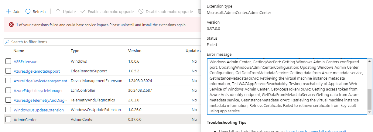

I have a problem with Extation Admin Center installed on my cluster Azure stack HCI 23H2 compossed from 2 noteds.
One of Nodes had a problem with Extation Admin Center. I try to remove and install newly but i have again the error.
the log is this:
Extension Message: Executing Enable operation, SettingDnsRecords:
Creating/updating DNS records, GetDataFromMetadataService:
Getting data from Azure metadata service, GetInstanceMetadataForArc:
Retrieving the virtual machine instance metadata information, GettingWacPort:
Getting Windows Admin Centers configured port, UpdatingWindowsAdminCenterConfiguration:
Updating Windows Admin Center Configuration, StoppingWindowsAdminCenterService:
Stopping Windows Admin Center service, UpdatingInstallationTypeSettings:
Updating Installation type for Windows Admin Center, UpdatingCSPSettings:
Updating CSP Frame Ancestors for Windows Admin Center, UpdatingCORSSettings:
Updating CORS origins for Windows Admin Center, UpdatingPort:
Updating port for Windows Admin Center, UpdatingWebSocketValidationOverride:
Updating WebSocket validation override settings, UpdatingTokenAuthenticationEnabled:
Updating token authentication setting, UpdatingAutoUpdate: Updating auto update setting, SettingProxy:
Updating proxy for Windows Admin Center, GettingWacPort:
Updating Windows Admin Center Configuration, GetDataFromMetadataService:
Retrieving the virtual machine instance metadata information, TestWACAppServiceReachability:
Testing reachability of Application Web Service of Windows Admin Center, GetAccessTokenForArc:
Getting access token from Azure Arc's identity endpoint, GetDataFromMetadataService:
Retrieving the virtual machine instance metadata information, RetrieveCertificate:
Failed to retrieve certificate from key vault using app service
How can i solve this issue?

    Hi Giovanni Luca Matera,I'm glad that you were able to resolve your issue and thank you for posting your solution so that others experiencing the same thing can easily reference this! Since the Microsoft Q&A community has a policy that "The question author cannot accept their own answer. They can only accept answers by others ", I'll repost your solution in case you'd like to "Accept " the answer.Issue: Having an issue with installing Windows Admin Center Extension on my Azure Stack HCI 23H2 cluster, which consists of two nodes. One of the nodes is experiencing problems with the Windows Admin Center. I tried to uninstall and reinstall it, but I'm still encountering the same error.
    Error log: Retrieving the virtual machine instance metadata information, Retrieve Certificate:
