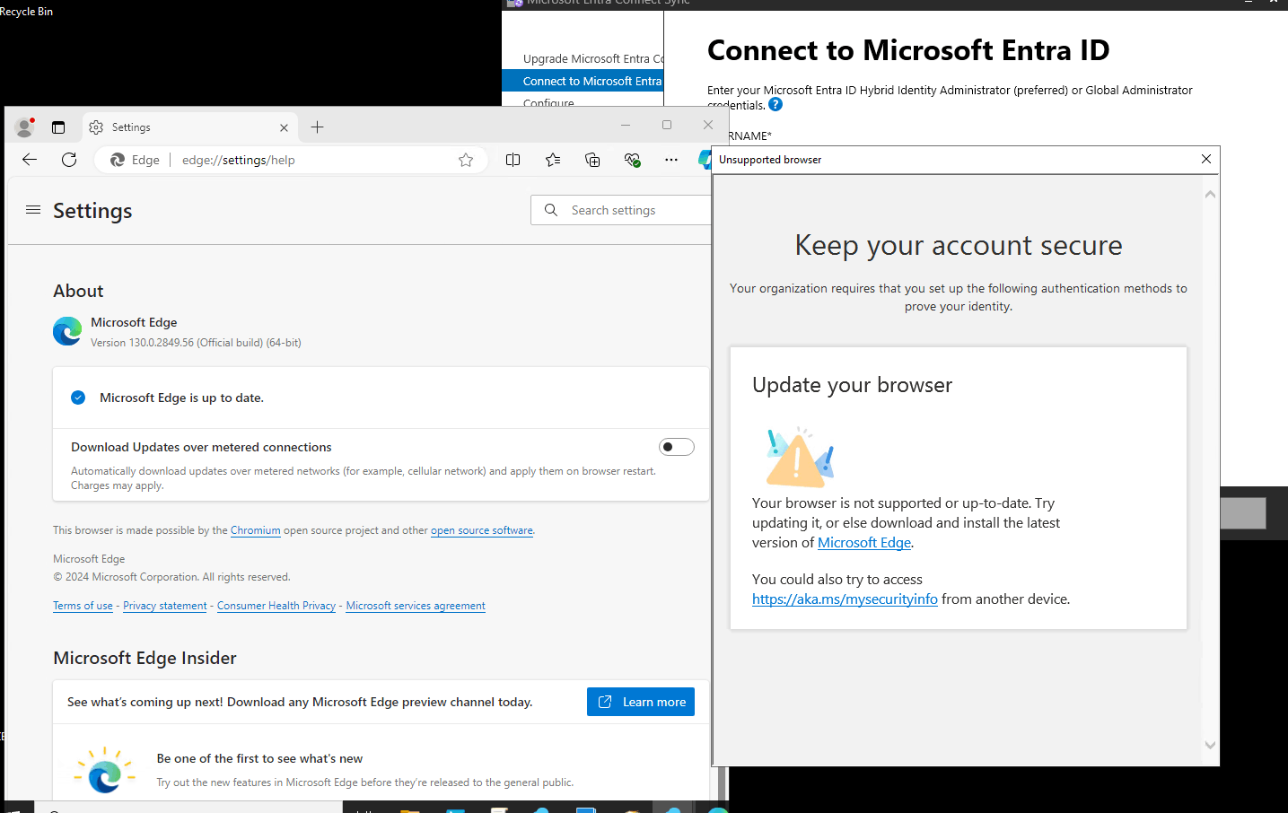

I'm trying to update Microsoft Azure AD Connect from 2.3.20.0 to 2.4.21.0. During the update process when trying to login I'm being redirected to a login window, account credentials are selected, MFA entered correctly - and the login screen changes to Keep your account secure / Update your browser.
The problem is according to Edge it is up to date.

    The message is misleading. After fiddling with 2FA it finally worked.

    "Forgetting" the cached account fixed it for me.
    At the authentication prompt during the Entra Connect setup i had an account with cached credentials.
    • I've updated entra connect to the latest version
    • ensured that my browser is running the latest version
    • disabled IE via DISM command.
    • And after I removed the cached creds, it worked.

    Here are a couple of things that may be the cause of this issue.
    1. TLS 1.2 is not configured.
    https://learn.microsoft.com/en-us/entra/identity/hybrid/connect/reference-connect-tls-enforcement
    1. Reboot server
    2. Reset all IE zone settings
    3. Restore advanced IE settings
    4. Turn off IE enhanced security settings
    5. Change default browser to IE or Microsoft Edge
    If those fail, check Event Viewer.
    You may see the following error:
    error_description":"AADSTS50079: Due to a configuration change made by your administrator, or because you moved to a new location, you must enroll in multi-factor authentication to access '00000002-0000-0000-c000-000000000000'
    This means the account being used needs to be registered with Azure MFA. I tried adding the account to exclusions in "Conditional Access policies" but that did not work, or I failed to give it time to replicate.
    Once I went through the registration, I was able to complete the sync between AD and Azure. I still find it stupid that it gives that false error about the browser being unsupported given that Edge and/or Chrome was installed on the server. IE is uninstalled by default in our corp. image of Windows Servers.
