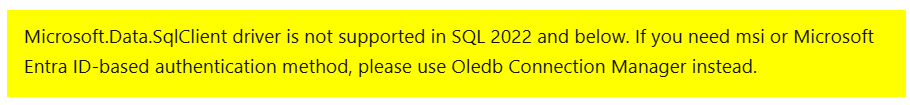

    Microsoft.Data.SqlClient driver is not supported in SQL 2022 and below. If you need msi or Microsoft Entra ID-based authentication method, please use Oledb Connection Manager instead.User's image
