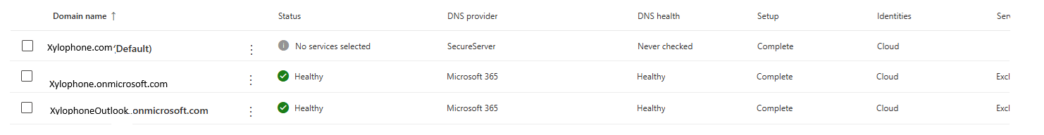

I'm hoping someone can help as we are having issues with our sharepoint domain.
I will try and keep this as short and detailed as possible.
We have our domain, lets call it Xphone.com. In our M365 admin centre, we have Xphone.com set as Default, but there are no Status listed.
Our mail goes through a Sophos mail filter so we don;t want to put in an MX record or anything to do with Skype.
Our domain has been verified under custom domain names in the Azure portal.
Currently our Sharepoint web address is being shown as XphoneOutlook.sharepoint.com. The XphoneOutlook.onmicrosoft.com has been selected as our fallback domain somehow.
We want to get out sharepoint domain to simply be X***phone.sharepoint.com
I believe that if we put a TXT DNS entry in our DNS provider then this will be fixed and the reason we are getting the wrong sharepoint address is because the DNS has not been verified and the X***phoneOutlook as our fallback domain has been verified and is being used instead.

    According to the information you provided and the research I have done, I may understand that you want to resolve the issue where DNS Health is showing as “Never checked” and Staus is showing as “No service selected”. If there is anything wrong, please correct me.
    Your solution is correct, and yes, setting the correct DNS entries with 123-reg should help resolve the SharePoint Online URL issue.
    1. The "Never Checked" status for your SharePoint domain's DNS health usually means that the DNS records haven't been verified or checked by Microsoft 365 yet. So, as a first step you need to configure all the necessary DNS records (MX, CNAME, TXT) for your DNS provider. References: Connect your DNS records at 123-reg.co.uk to Microsoft 365 Add DNS records to connect your domain
    2. The "No services selected" status for your SharePoint domain typically indicates that the domain has been verified, but the necessary services have not been configured yet. Here are some steps to configure this:
      • Go to the Services tab.
      • Select the services you want to use with this domain (e.g., Exchange, SharePoint, Teams).
      • Click Save to apply the changes.

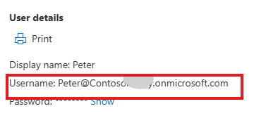

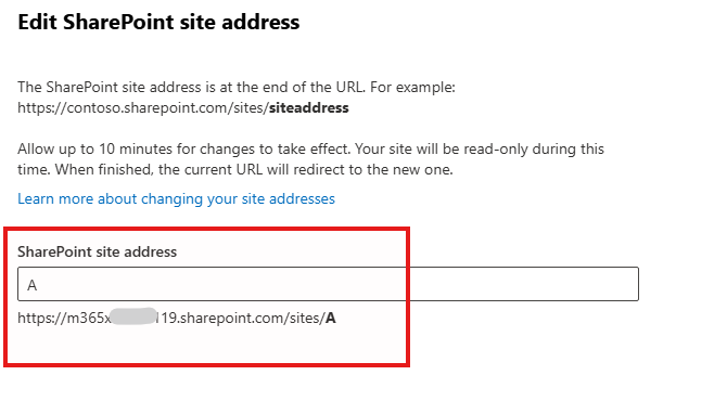

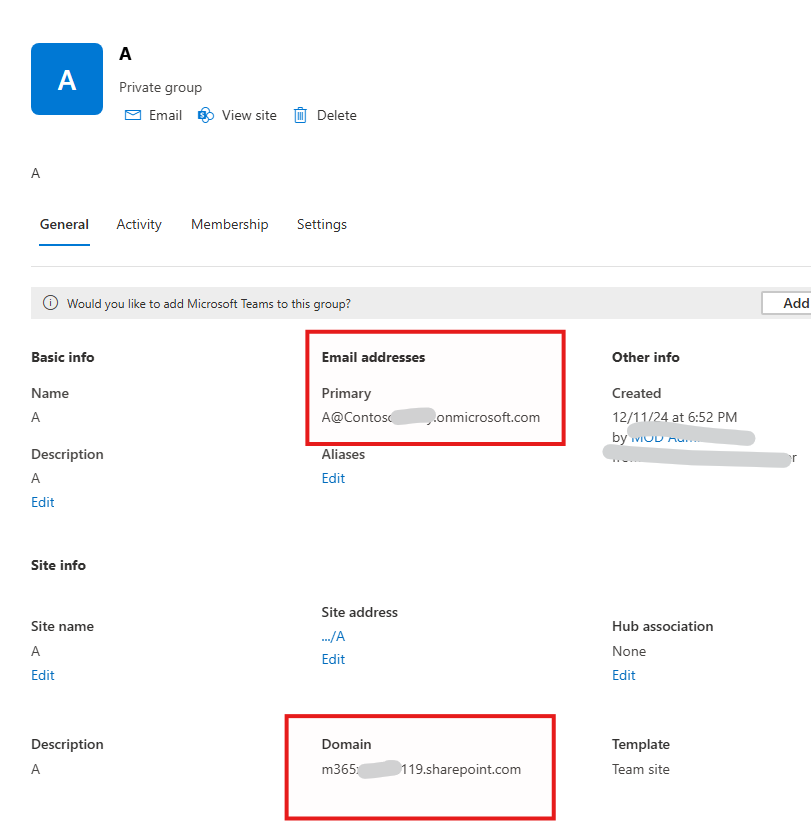

    I tested it again my internal environment:
    When I add a new user, the user's email address uses the fallback domain.
    When I add a new site, the user group's email address uses the fallback domain name but the site's URL stays with the original domain name.
