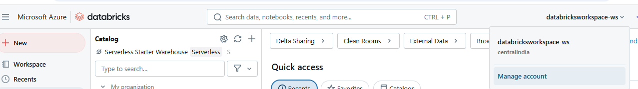

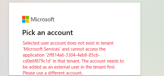

Not Able To Access DataBricks Manage Account Console. Logging through global admin account. Can anyone help what to be done to resolve this.
Rahul Goel 0 Reputation points
2024-12-18T19:09:28.6366667+00:00
Getting above error when try to click on manage account in databricks. Can anyone guide me to resolve this issue.

  1. Ganesh Gurram 7,235 Reputation points Moderator
    2024-12-18T23:07:51.6866667+00:00
    Hello @Rahul Goel
    Greetings & Welcome to Microsoft Q&A forum! Thanks for posting your query!
    Please refer to the links provided below, as they might offer some insights that could help you address your question.
    https://community.databricks.com/t5/administration-architecture/unable-to-login-to-azure-databricks-account-console/td-p/82190
    https://github.com/cloudboxacademy/azure_databricks_course/blob/main/known-issues/unable-to-login-to-azure-databricks-account-console.md
    Please refer to MS Q&A thread - Can't access the Azure Databricks Accounts Console addressing similar issue.
    Hope this helps. Do let us know if you have any further queries.
  2. Q&A Assist
    2024-12-18T19:09:28.6666667+00:00
    If you are unable to access the Azure Databricks Manage Account Console while logging in with a Global Administrator account, ensure that the account has the necessary permissions. Only someone with the Microsoft Entra ID Global Administrator role can assign the first account admin role. If you have not yet been assigned the account admin role, you may need to follow these steps:
    1. Confirm that you are using the correct Global Administrator credentials to log in.
    2. If you are the Global Administrator, go to the Azure Databricks account console at accounts.azuredatabricks.net.
    3. If you still face issues, it may be necessary to engage someone who has the Microsoft Entra ID Global Administrator role to assign you the account admin role.
    If the problem persists, consider checking for any specific error messages or issues related to your Azure subscription that might be preventing access.
