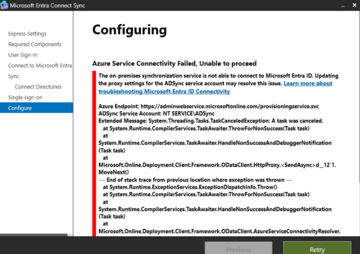

My AAD (Entra Connect Sync) migration doesn't work.

  13. The error I can't understand is in the screenshot, after all the deployment steps are completed. -> Told to click install and enable staging mode.

  1. Thameur-BOURBITA 36,261 Reputation points Moderator
    2024-12-24T13:37:17.88+00:00
    Hi @Čako Martin
    If you are using a proxy for EntraConnect server to access to internet you have to add it in machine.config file as mentioned in this article:
    https://learn.microsoft.com/en-us/entra/identity/hybrid/connect/how-to-connect-install-prerequisites#connectivity

  1. Akhilesh Vallamkonda 15,320 Reputation points Microsoft External Staff Moderator
    2024-12-24T11:52:59.0833333+00:00
    Hi @Čako Martin
    Thank you for reaching us!
    I understand that you are unable to configure the Entra connect tool, and you are getting an error related to Azure Service Connectivity Failed. Unable to proceed.
    This might be the issue with the .NET Framework can you please check the .NET Framework the minimum .NET Framework version required is 4.6.2, and newer versions of .NET are also supported. .NET version 4.8 and greater offers the best accessibility compliance.
    Update the .Net Framework and check the all the Installation prerequisites and re-install the Entra connect tool and see if the issue is fixed.

  2. Akhilesh Vallamkonda 15,320 Reputation points Microsoft External Staff Moderator
    2024-12-25T14:14:27.03+00:00
    Hi @Čako Martin
    I'm glad that you were able to resolve your issue and thank you for posting your solution so that others experiencing the same thing can easily reference this! Since the Microsoft Q&A community has a policy that "The question author cannot accept their own answer. They can only accept answers by others ", I'll repost your solution in case you'd like to "Accept " the answer.
    Issue:
    when you are configuring the Entra connect tool you got the below
    Error: Azure Service Connectivity Failed. Unable to proceed The on-premises synchronization service is not able to connect to Microsoft Entra ID. Updating the proxy settings for the ADSync service account may resolve this issue. treublesh9Qting tp Connectiyity
    Solution:
    you have fixed the issue by adding https://secure.aadcdn.microsoftonline-p.com to the trusted sites. I checked versions and everything was up to date. We don't use proxy, so I edited the C:\Windows\Microsoft.NET\Framework64\v4.0.30319\Config\machine.config to <system.net> AI ConvertCopy
    `**<defaultProxy enabled="false" />**
    </system.net>
    If you have any other questions or are still running into more issues, please let me know. Thank you again for your time and patience throughout this issue.
