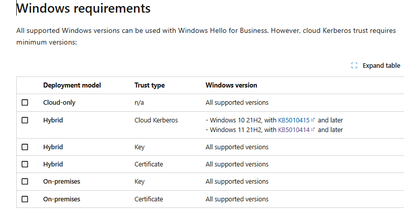

    Meanwhile, please ensure the requirements are all met. Here is the windows requirement for your reference. (If the deployment mode is Hybrid and the trust type is Cloud Kerberos. please ensure the window version is supported and with the latest updates installed.)
    Please try the above suggestion and if there's any update, feel free to let us know.
