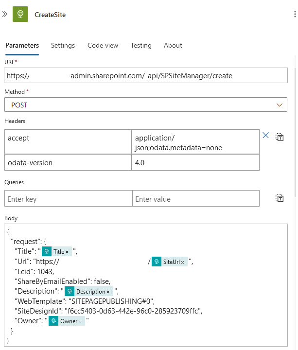

I am trying to provision a SharePoint communication site programmatically using SharePoint REST api (_api/SPSiteManager/create). Hence no problems here. Site gets created without any problems using a predefined body.

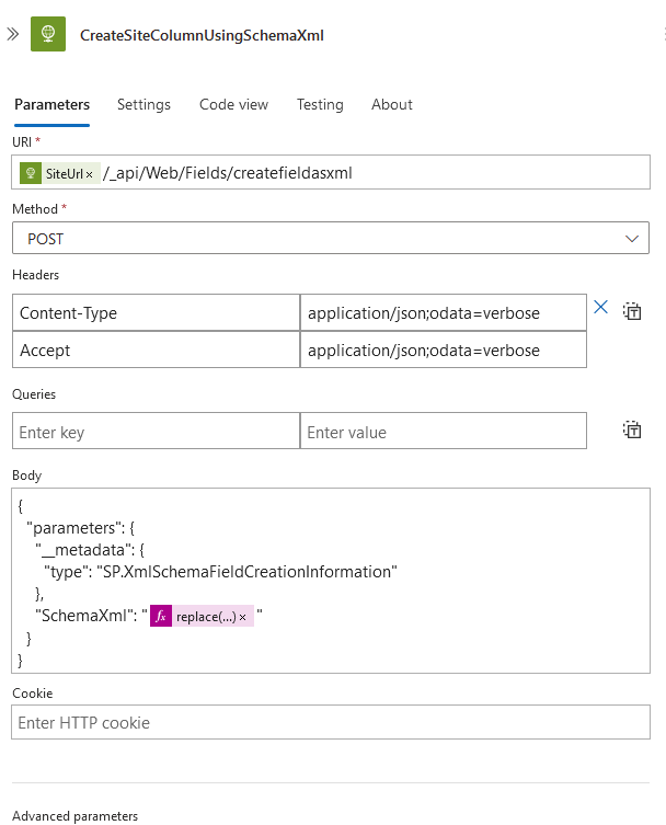

In my workflow I also provision multiple columns (at the site level) using SchemaXML (_api/Web/Fields/createfieldasxml). The internal name and display name differ. No problems here. It is possible to share the XML, but I do not think this is the problem.
After creating the SharePoint columns at the site level I want to add them to the default SharePoint SitePages library using the same SchemaXml (_api/Web/Lists(guid'{GUID of SitePages lib.}')/Fields/createfieldasxml). Hench the problem (I think).
It appears that when provisioning the site programmatically (_api/SPSiteManager/create), a not so unique GUID, is being used for the SitePages library. I found the following article explaining this problem: https://www.wictorwilen.se/blog/when-a-guid-is-not-really-unique-i-m-looking-at-you-sharepoint/
