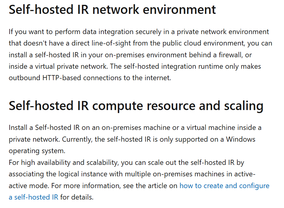

    Hi @Nikunj Patel
    Thanks for the question and using MS Q&A platform.
    The self-hosted IR (Integration Runtime) does not need to be deployed in either GCP or Azure. It can be deployed on a machine in your on-premises network that has a private connection (VPN or ExpressRoute) to Azure.
    The self-hosted IR acts as a bridge between Azure Data Factory and your on-premises data sources. It securely transfers data between your on-premises storage and Azure storage without going over the public internet.
    To connect the self-hosted IR to Google Cloud Storage, you configure a linked service in Azure Data Factory to connect to Google Cloud Storage. Then, specify the self-hosted IR as the integration runtime for this linked service. When the data transfer activity is triggered in Azure Data Factory, it runs on the self-hosted IR in your on-premises network. Finally, the self-hosted IR uses the private connection (VPN or ExpressRoute) to connect to Google Cloud Storage and transfer the data.
    For more details refer to this: https://learn.microsoft.com/en-us/azure/data-factory/connector-google-cloud-storage?tabs=data-factory#copy-data-from-google-cloud-storage-using-azure-data-factory-or-synapse-analytics
    Hope this helps. Do let us know if you have any further queries.
