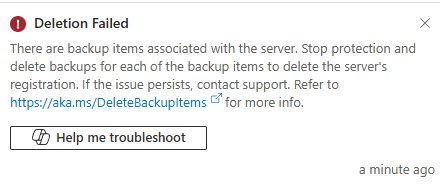

Hi, we have several old backups in Azure that were created from an on-prem Microsoft Azure Backup Server that no longer exists.
If I try to delete the old backups, it says that the backup job needs to be stopped but since I don't have access to the MABS, I can't stop the jobs.
Any way around this?
