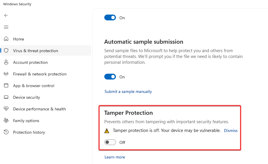

    1. Open Windows Security -> Under Virus & threat protection, click Manage settings -> find Tamper Protection - > toggle it Off

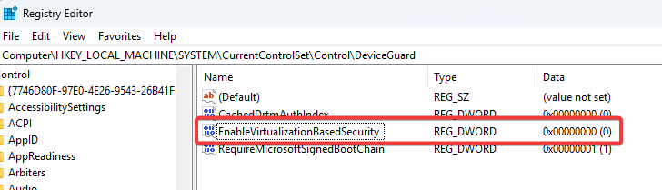

    2**.** Open Registry Editor Navigate to this path:HKEY_LOCAL_MACHINE\SYSTEM\CurrentControlSet\Control\DeviceGuard -> create DWORD EnableVirtualizationBasedSecurity -> set its value to 0
    1. Restart the PC and check again.
    I hope the information above is helpful.
