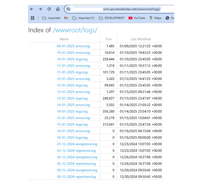

Problem Statement: I have an Azure app service, and its log is generated under the https://<prod_server>.scm.azurewebsites.net/wwwroot/logs/. I am able to access it from the browser as my default credential is already logged in with. I am trying to achieve the same using Golang code running from my code editor (i.e. Visual Studio Code).

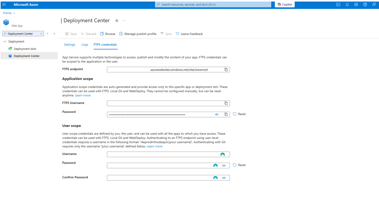

I am using the credentials: (please refer the screenshot below)

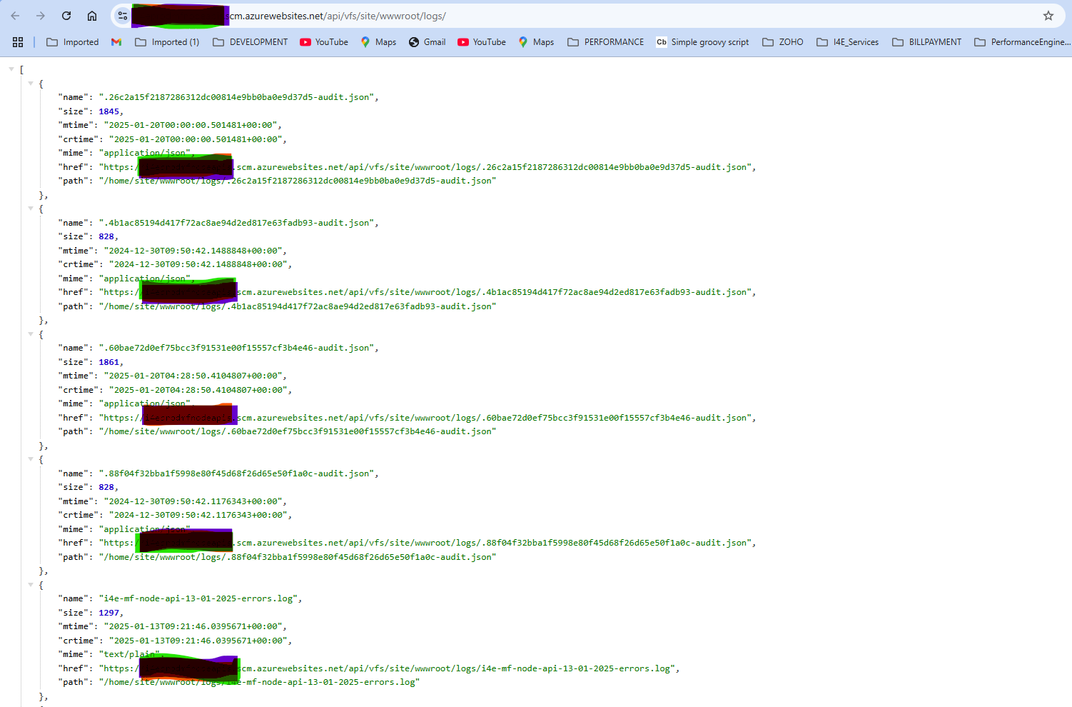

I am able to access it from the browser:

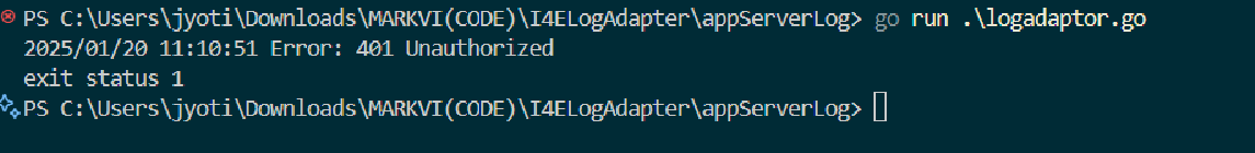

Why am I observing the below error?
Now if I try the same user name and password in FTP tools like WinScp, it works like a charm. But the above code is giving me the following error:
2025/01/16 12:03:25 Error: 401 Unauthorized
exit status 1
