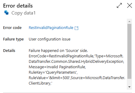

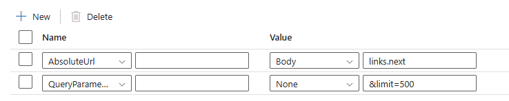

I am running calls on an API, where my base URL specifies a query parameter "limit=500" to return a max of 500 records in the response. I have an AbsoluteURL pagination rule set up to follow a next-page URL provided in the response. When the subsequent call runs, the response returns up to 30 records, which is the default limit (instead of 500).
How can I add this limit to subsequent calls?
Here is how I've attempted so far, and the error it provides:

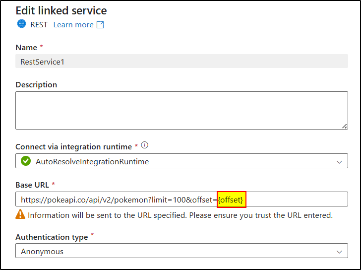

    The error occurs because the QueryParameters pagination rule was incorrectly defined or conflicts with the API's structure. Specifically, the value &limit=500 as a QueryParameters rule is invalid in this context. The correct way to define pagination rules for APIs like involves dynamically updating the offset query parameter without appending raw query strings.
    I tried to replicate the scenario and able to pass the query parameter values. I took the following API
    API link: https://pokeapi.co/api/v2/pokemon?limit=100&offset=0
    Base URL: https://pokeapi.co/api/v2/pokemon?limit=100&offset={offset}
    Here I have created a variable called offset in the URL and need to pass the values. User's image User's image
    For more details, please refer:REST
    Output:
