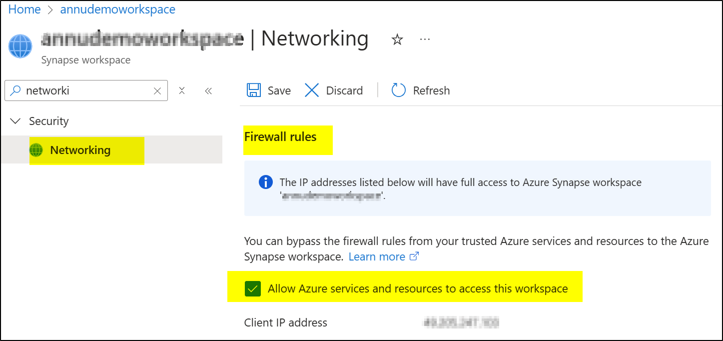

    The error you are encountering while trying to copy data from AWS Redshift to Azure Synapse suggests that there is a connectivity issue with the SQL Database. User's image
    Here are some potential causes and solutions:
    Linked Service Configuration: Ensure that the linked service configuration for your Azure Synapse Analytics is correct. Check the server name, database name, and user credentials.
    Firewall Settings: Verify that the SQL Database firewall settings allow access from the integration runtime being used. You may need to add the IP address of the integration runtime to the allowed list.
    Remote Connections: Make sure that the SQL Server is configured to allow remote connections. This can be checked in the SQL Server Management Studio under server properties.
    Network Issues: The error message indicates a possible network-related issue. Ensure that there are no network restrictions or outages that could be affecting connectivity to the SQL Database.
    SQL Server Instance: Confirm that the SQL Server instance is running and accessible. If it is a named instance, ensure that the instance name is specified correctly.
    By addressing these areas, you should be able to resolve the connectivity issue.

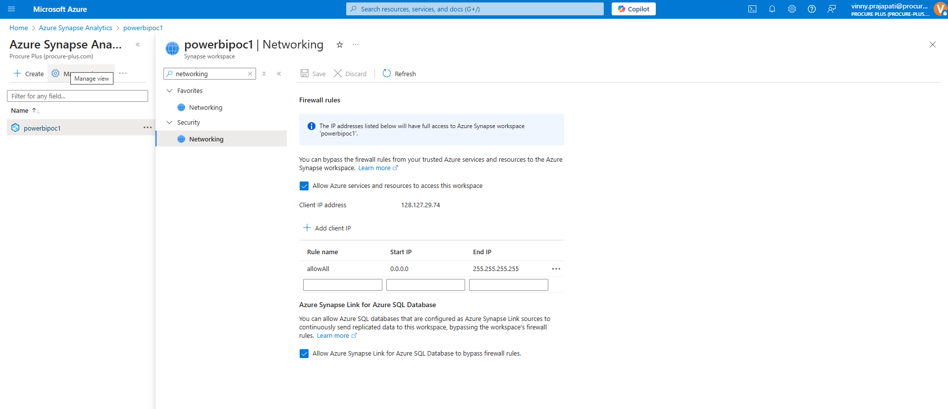

  2. Vinny Prajapati 5 Reputation points
    2025-02-26T18:53:08.5266667+00:00
    Hi @AnnuKumari-MSFT
    Do you mean like below, I've added in the contributor role to synapse for ADF? I tried this and it did not work. Do we need to add any roles to ADF?
    Synapse - IAM Role
