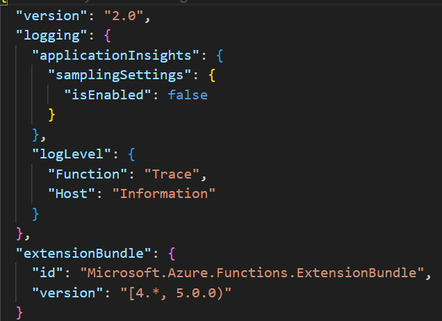

    You can enable verbose logging in Application Insights by modifying your host.json file like this:
      "logging": {
        "applicationInsights": {
          "samplingSettings": {
            "isEnabled": false
          "logLevel": {
            "Function": "Trace",
            "Host": "Information"
    This will help track all interactions and might provide you with more detailed logs on whether specific requests, errors, or scaling events are related to the issue you're facing.
