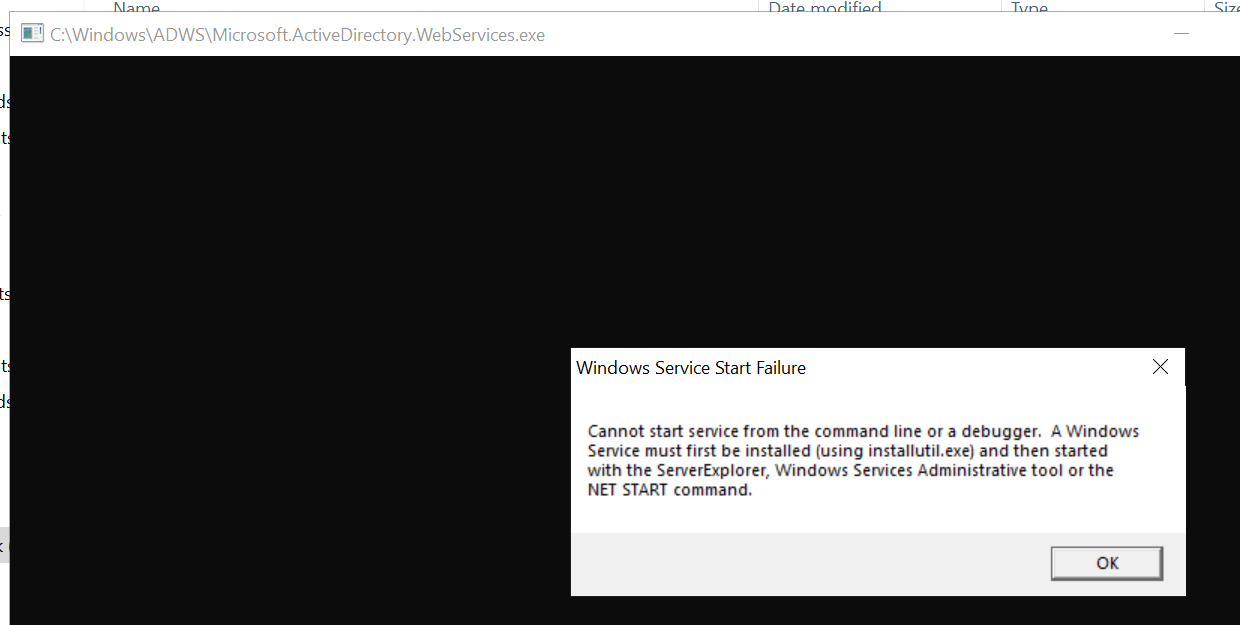

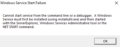

    No. I am hoping it does not come to that. What is missing on both controllers is the ADWS service itself. In the directory above, "Microsoft.ActiveDirectory.WebServices.exe" is found. This would be the executable called upon as ADWS when installed as a service correct? If double clicked, you get this:
    To me, this seems to elude to the available option of installing (re-installing) Microsoft.ActiveDirectory.WebServices.exe as a service using "installutill.exe".
    The whole issue is that ADWS is no longer running as a sercvice and that's what Active Directory Administrative Center is complaining about when I attempt to open it. Same as certain powershell commands. If the service itself could be re installed, I am thinking this would resolve the issue at hand. Does this make sense?

    Hello
    Good day!
    When I click C:\Windows\ADWS\Microsoft.ActiveDirectory.WebServices.exe on the DC in my lab., I have the same error message as you.
    But the AD WS service is running well.
    You can try to find if there is AD WS service and it is disabled only.

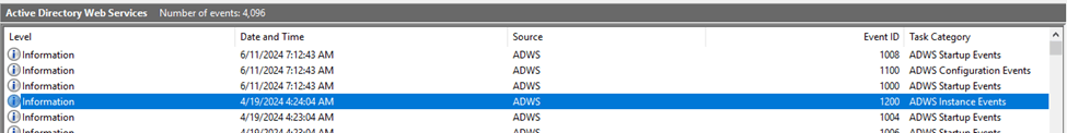

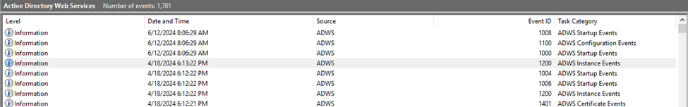

    I just noticed something clearly a little on the strange side.
    Poking through events logged under Active Directory Web Services.
    I see when it stopped adding entries mid-April this year and began again after the application of the June 2024 Cumulative update mentioned above. This behavior noticed on both DCs.
    Event ID 1000 - Active Directory Web Services is starting.
    Event ID 1100 -The values specified in the <appsettings> section of the configuration file for Active Directory Web Services have been loaded without errors.
    Event ID 1008 - Active Directory Web Services has successfully reduced its security privileges.
    So how can a service that is completely missing, not disabled, begin to add event entries after a two-month hiatus?
