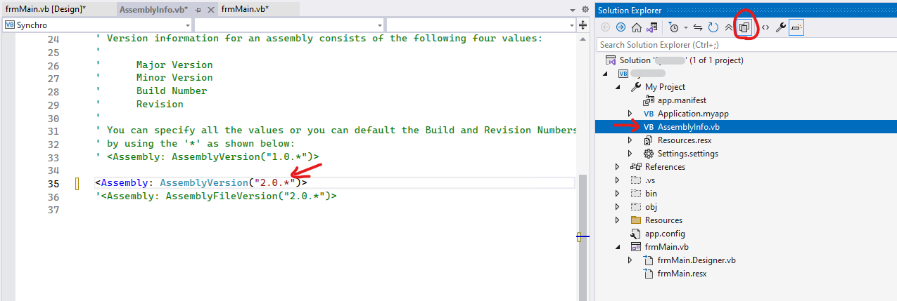

    I notice that the hot reload issue you got is impacted by the configuration for AssemblyVersion property.

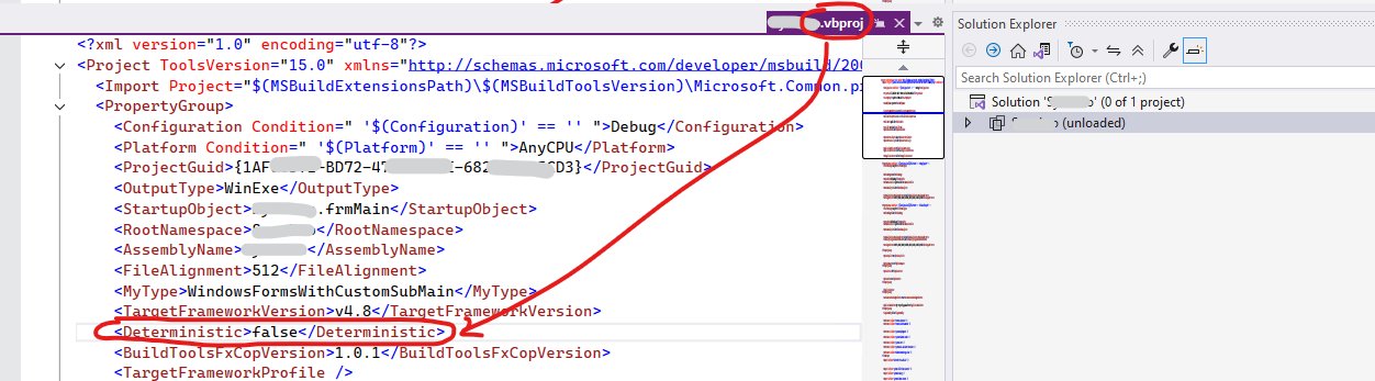

    In AssemblyInfo.vb file, it was set to <Assembly:AssemblyVersion("2.0.*")>(with <Deterministic> property set to false, in the .vbproj file).

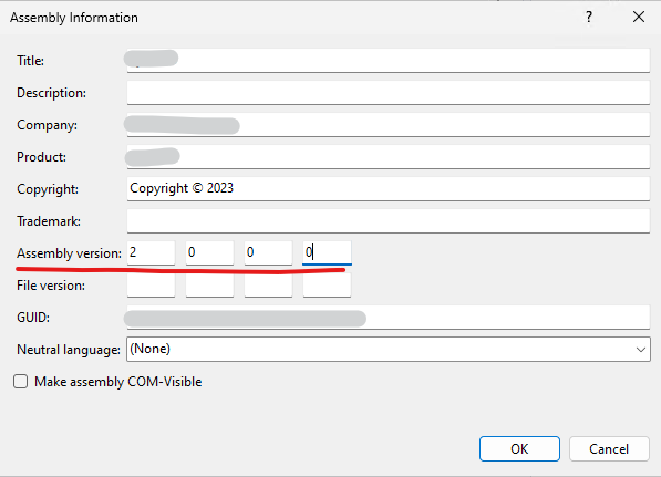

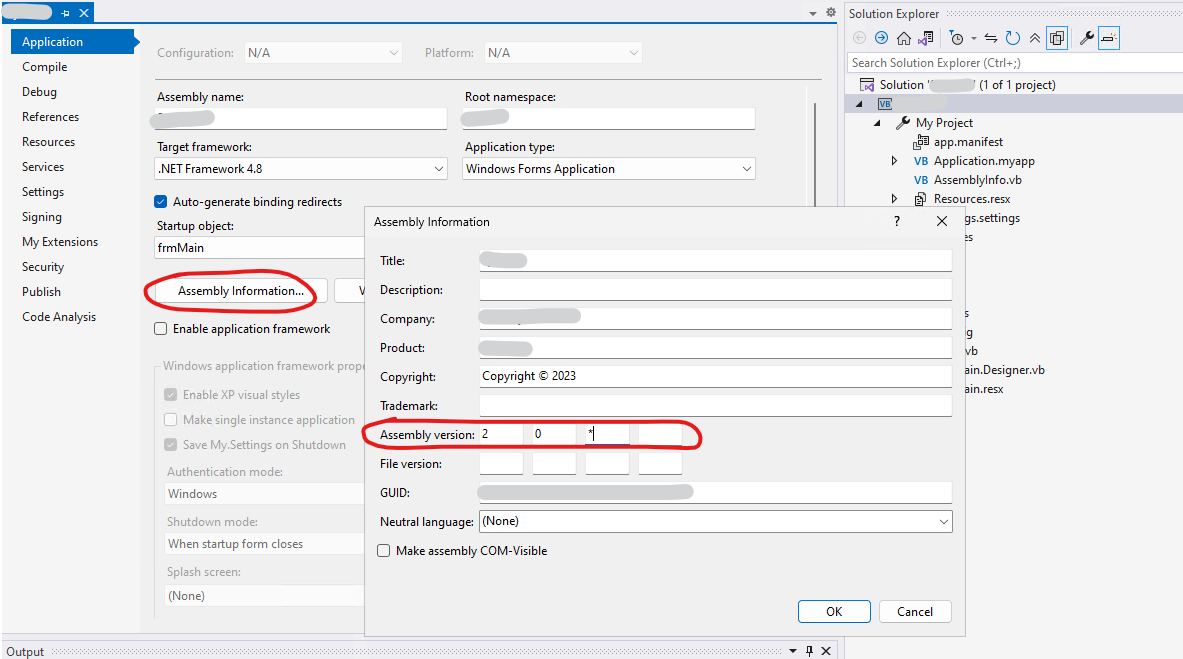

    By the way, the AssemblyVersion property can be set/checked by right-clicking the project > Properties > Application > Assembly Information > Assembly version.

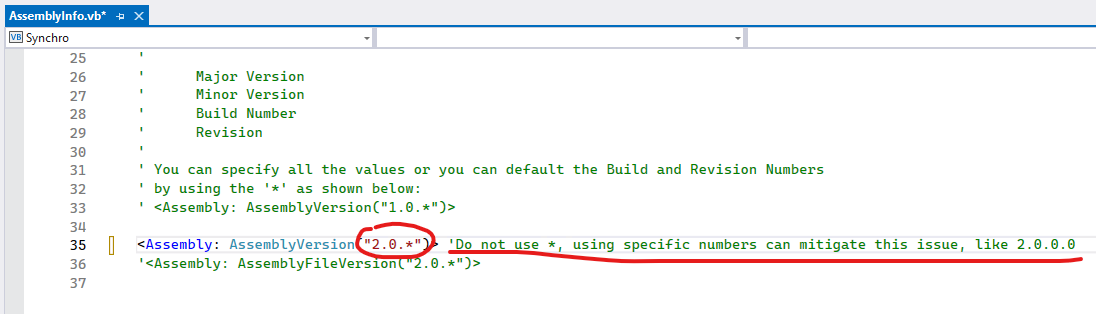

    Currently, if you want to mitigate this issue, you can set and use a specific assembly version, instead of using wildcard *.
    For example, changing 2.0.* to 2.0.0.0.
