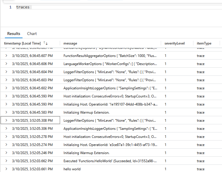

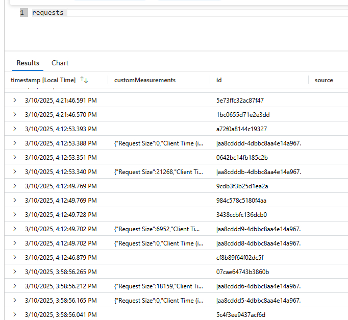

For almost 3 hours (3:52 PM - 6:36 PM) no traces were logged in my Application Insights. During this time many requests were made that should have triggered the functions that log traces. How can I know if these functions executed as expected? And why were there no traces logged?
Traces (Notice gap between 3:52 - 6:36)
Requests (notice that all requests shown in the screenshot are made in the gap of the missing traces)

    This was due to results being limited to 1000 items in the Log Query editor.

    Issue:
    Azure Application Insights stopped logging traces for nearly 3 hours, even though requests were made during that time.
    Resolution:
    The missing traces were due to the Log Query editor limiting results to 1,000 items. Refining the query to retrieve more results made the traces visible.
    Essential Insights:
    • Query result limits: Application Insights log queries have a default limit on the number of results returned. If data seems to be missing, try adjusting the query parameters.
    • Diagnostic tools: Azure Monitor and Diagnostic Logs can help confirm if functions executed as expected.
    • Workbooks & visualization: Understanding Azure Workbooks' data source limits can aid in better visualization and troubleshooting.
