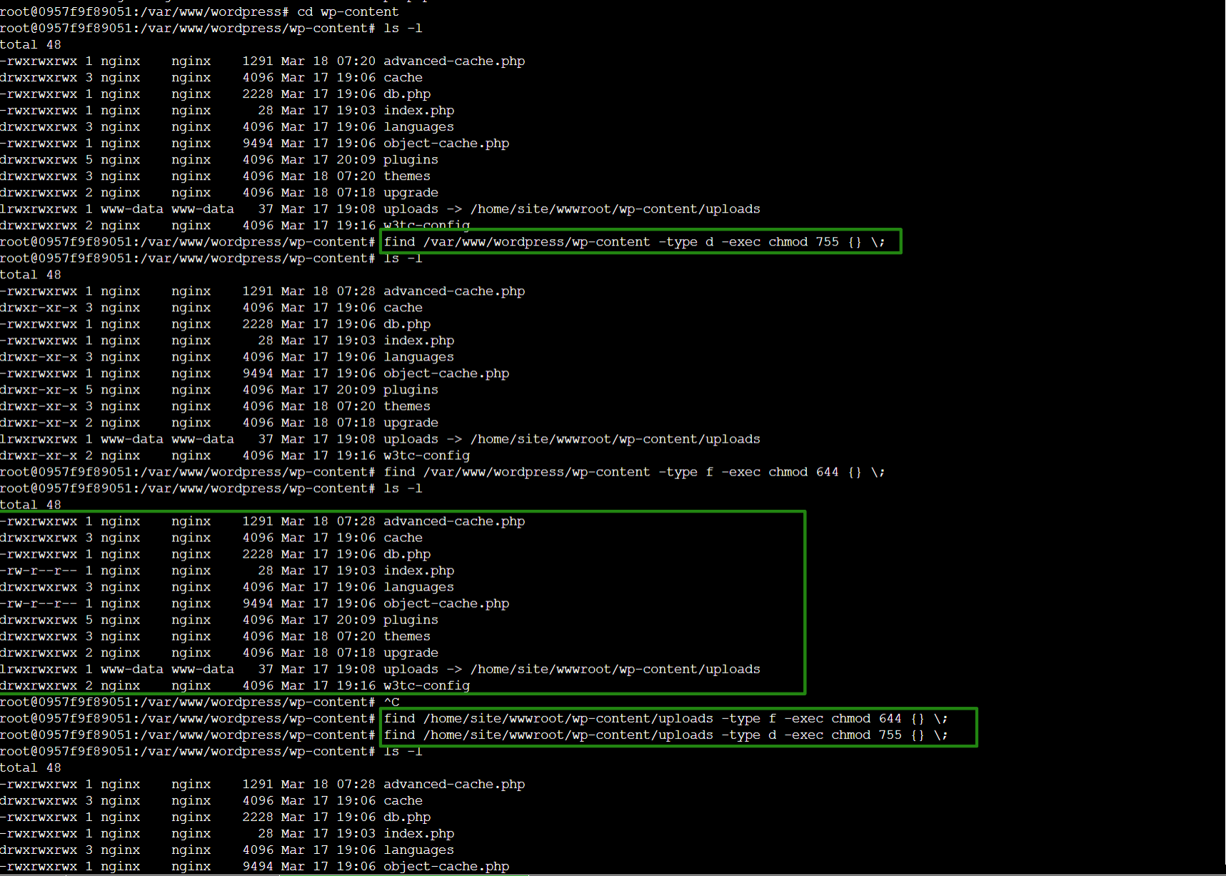

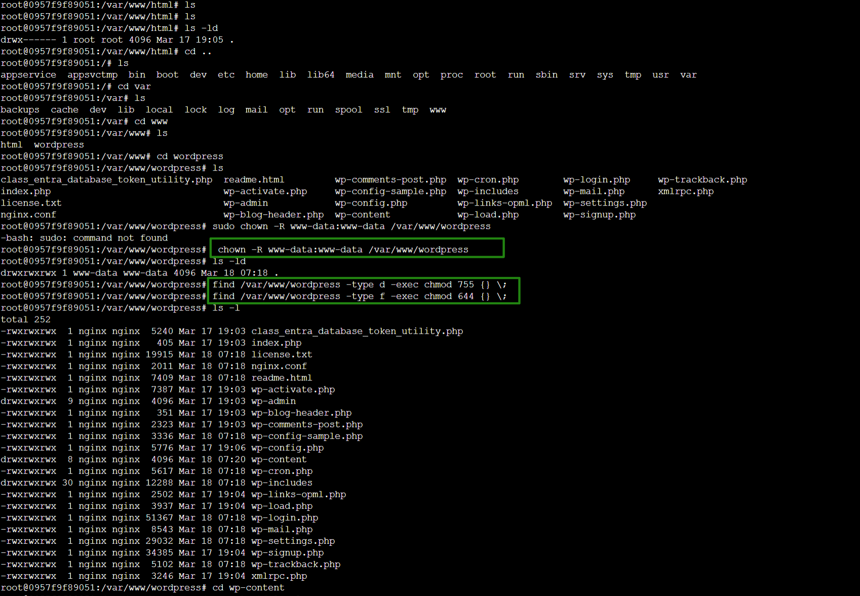

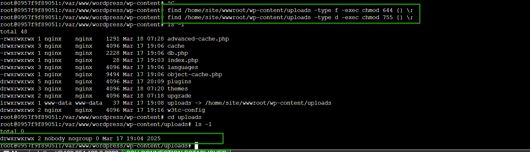

    I have followed all the suggested steps, including changing ownership to www-data:www-data and setting the correct permissions using the find commands. However, despite these changes, I am still unable to modify wp-content. It remains set to 777, and I am not allowed to change it, even when using the appropriate commands.
    To provide more context, I have attached three screenshots that illustrate the issue I am facing. Could you please assist me in identifying why I am unable to apply these changes and how I can resolve this issue?
    I appreciate your support and look forward to your guidance.
