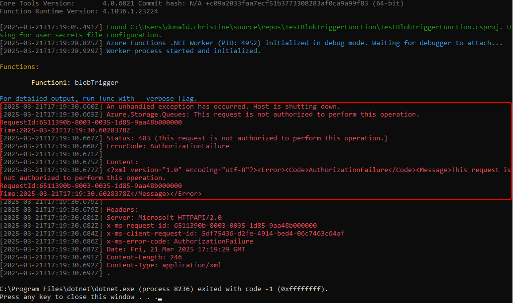

    Hi Pravallika Kothaveeranna Gari - We resolved the issue yesterday. We had to configure the storage account with a private endpoint for the Storage.Queue. We're assuming that the storage account uses the queue to deliver the PutBlob event to the function. Thanks for all of the assistance.

    2. Check the LogStream for the error details.
    unhandled exception is encountered (403 No Access) and then the Host shuts down.
    This error occurs when you don't have the proper permissions or when incorrect authentication is used to access the Storage account.

    The issue is resolved by configuring the storage account with a private endpoint for the Storage.Queue
