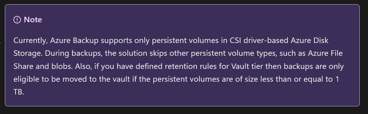

    I understand that you are experiencing issues when trying to restore snapshots from your AKS backup of Azure File CSI.
    As per the note here https://learn.microsoft.com/en-us/azure/backup/azure-kubernetes-service-backup-overview the issue you are facing is expected as the operation are not supported.
    Below you can find more details :
    https://learn.microsoft.com/en-us/azure/backup/azure-kubernetes-service-cluster-backup-support-matrix#limitations
    Please do not forget to "Accept the answer” and “up-vote” wherever the information provided helps you, this can be beneficial to other community members.
