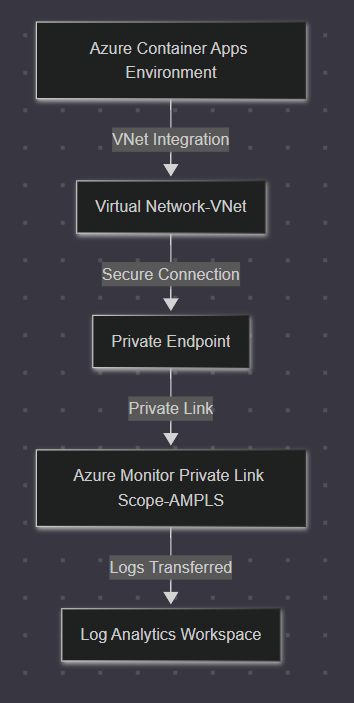

Dear team,
I implement Azure Monitor Private Link Scopes in order to send logs from Azure container apps environment to log analytic workspace.
But I see it doesn't work. It works in the first time. I can see log in the first time. But after that I don't see the new log.
Please help to check.
Thank you!

  1. Luis Arias 8,621 Reputation points Volunteer Moderator
    2025-03-29T19:33:22.5166667+00:00
    Hi Van Huy Tuyen,
    Looks like you're dealing with some log issues when sending data from your Azure Container Apps environment to a Log Analytics workspace. It worked at first, but now nothing’s showing up frustrating, Let’s troubleshoot this step by step:
    This is the expected setup:
    • Make sure everything is properly configured in Azure Monitor Private Link Scopes. Sometimes, it’s easy to miss a step when connecting to the Log Analytics workspace.
    • Head to the portal and confirm your Container Apps environment is still hooked up to the Private Link Scope. There could be a hiccup there.
    • Make sure the private endpoint tied to the scope is active and set up correctly. DNS settings, NSGs (network security groups), or route tables might be blocking things—worth a look.
    • Check out the logs and see if there are any error messages. Also, verify that permissions are all good on the resources you're using.
    • If none of this works, try removing and re-adding the connections between the environment, Private Link Scope, and Log Analytics workspace. Sometimes a clean slate fixes things.
    Finally to ensure the setup works, you can test sending a log message from within the VNet to the Log Analytics workspace using Azure CLI:
