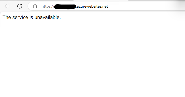

When opening the Functions website, a screen with the text “The service is unavailable” is displayed.
However, when the virtual network integration is disconnected, a normal screen is displayed.スクリーンショット 2025-03-28 151525

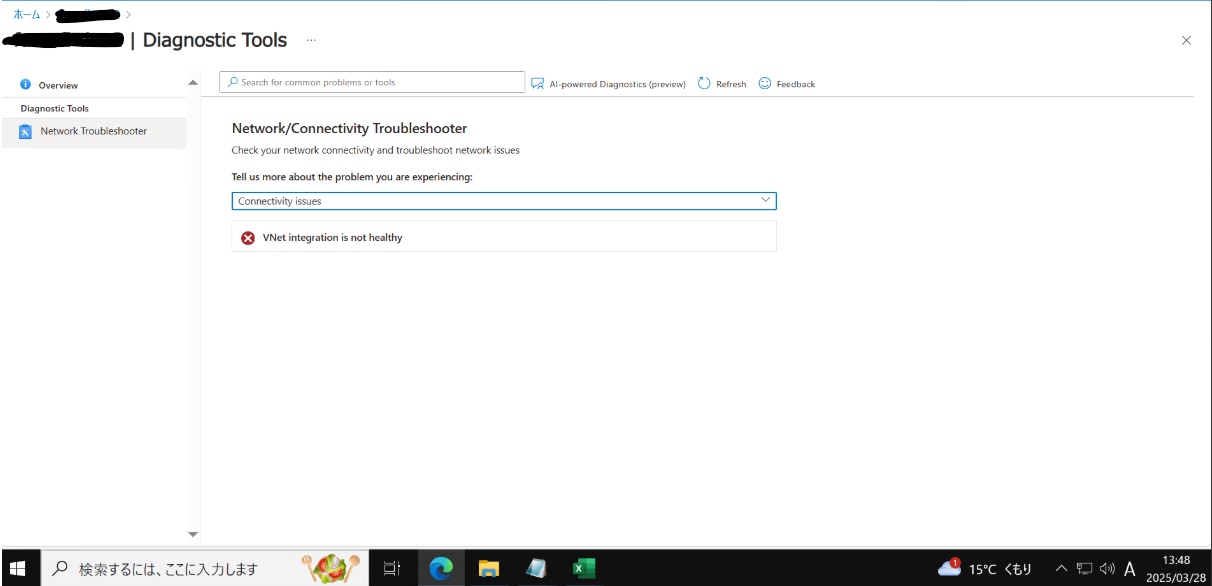

◆Open the Troubleshooting Tools > Diagnostic Tools > Network/Connectivity Troubleshooter and select Connectivity issues, and you will see the following error message for virtual network integration. The following error occurs for virtual network integration.
▼ Error message
VNet integration is not healthyスクリーンショット 2025-03-28 150154

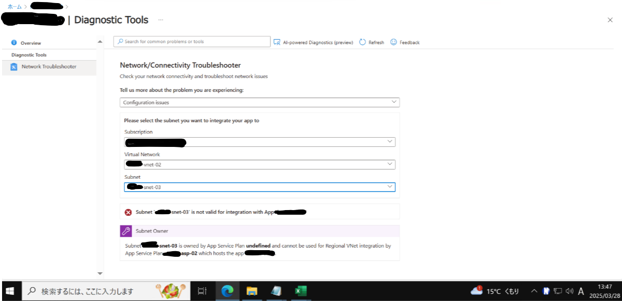

◆Open the Troubleshooting Tools > Diagnostic Tools > Network/Connectivity Troubleshooter and select Configuration issues. The following error occurs for virtual network integration.
▼ Error message

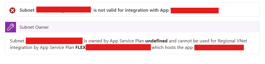

Subnet 'snet-03' is not valid for integration with App '{Functions Name}'
Subnet snet-03 is owned by App Service Plan undefined and cannot be used for Regional VNet integration by App Service Plan asp-02 which hosts the app { Functions Name}.スクリーンショット 2025-03-28 150419 *asp-02 is an App Service Plan created at the same time when Functions are created.

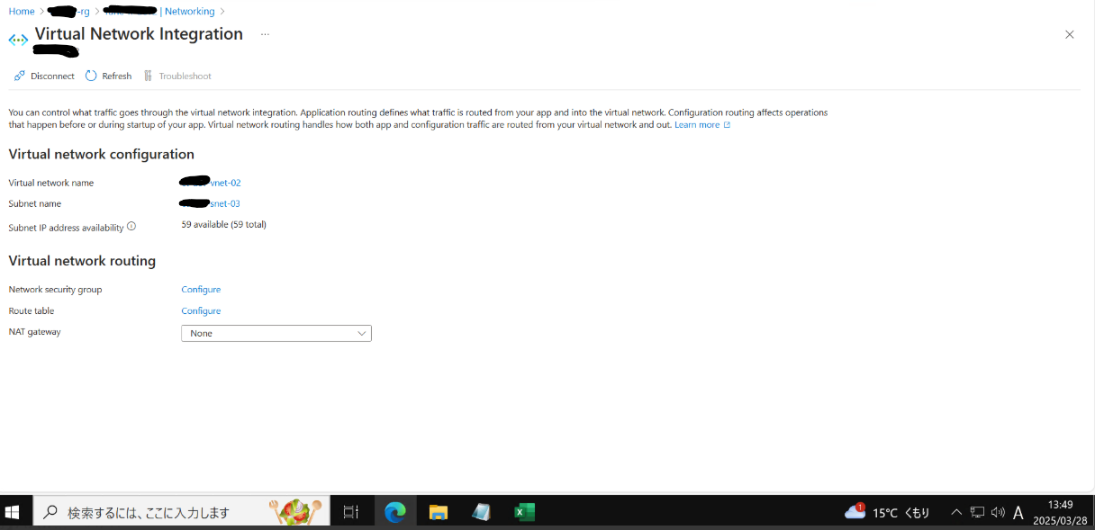

◆The configuration screen for virtual network integration in Functions is as follows.スクリーンショット 2025-03-28 150737

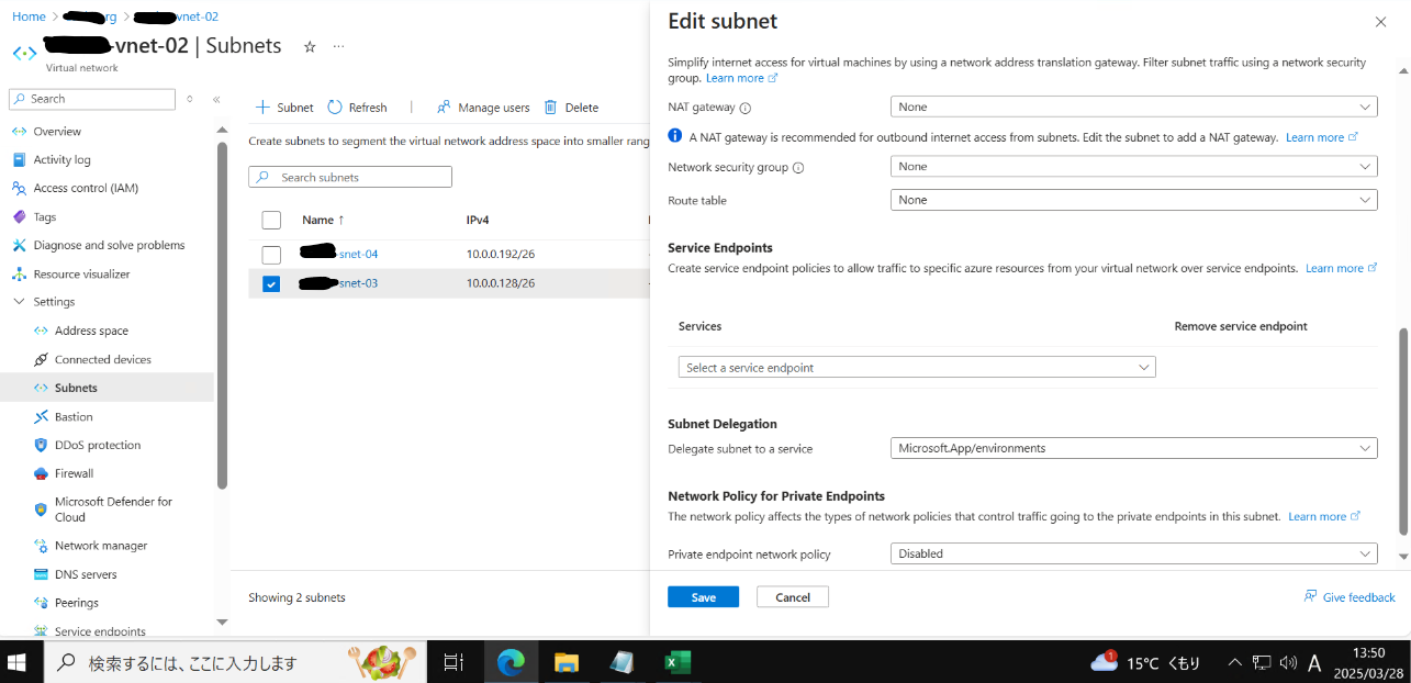

◆The setting values for the subnets subject to virtual network integration are as follows.
スクリーンショット 2025-03-28 150908
スクリーンショット 2025-03-28 151156
スクリーンショット 2025-03-28 151326
