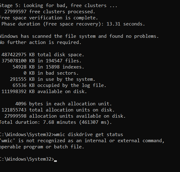

reinstalled the c partition, and now this appeared,
bitlocker status
BitLocker Drive Encryption: Configuration Tool version 10.0.26100 Copyright (C) 2013 Microsoft Corporation. All rights reserved. Volume D: [] [Data Volume] Size: 464,84 GB BitLocker Version: 2.0 Conversion Status: Used Space Only Encrypted Percentage Encrypted: 100,0% Encryption Method: XTS-AES 128 Protection Status: Protection Off Lock Status: Unlocked Identification Field: Unknown ERROR: An error occurred (code 0x80070017): Data error (cyclic redundancy check).

Based on the information mentioned above, I understand you’re encountering an error on your Volume D after reinstalling your C partition. The specific error code 0x80070017 (“Data error (cyclic redundancy check)”) is usually associated with data corruption or hardware problems.
And from the chkdsk command result, it seems Windows has scanned the file system and found no problems. No further action is required.
