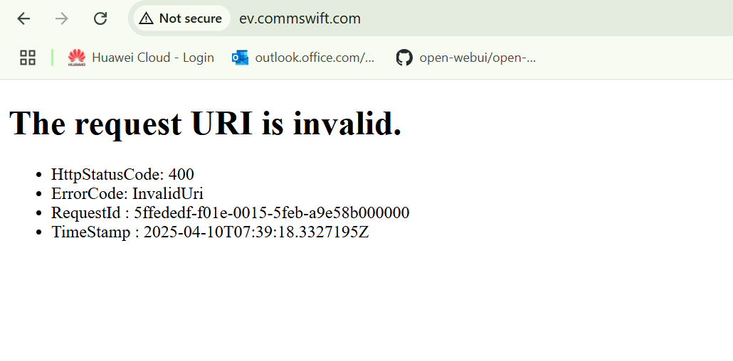

We have hosted the static website under a storage account's static website feature. The site is now deployed and working as expected. However, we want to configure a custom domain. We have tried using Front Door and a CDN profile, but it's still not working as expected.
see the following errors and configuration screenshots,
Please guide us where we have problem.

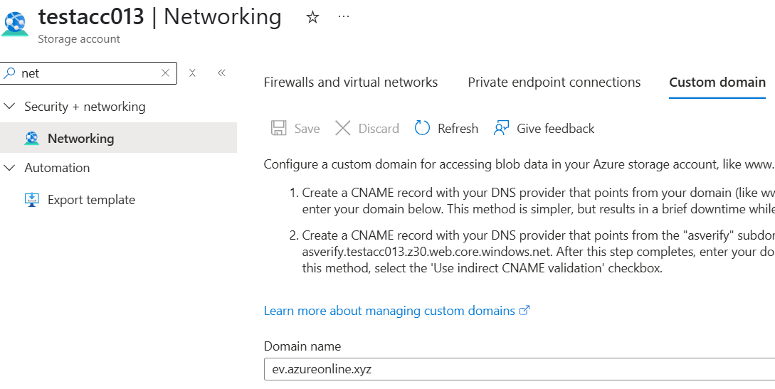

    I understand you were unable to access the custom domain mapped to either the storage account static website or Azure Front Door service. This issue can occur if the custom domain is not registered on the storage account as shown below:
    Storage account --> Networking --> Custom domain
    Once you register the custom domain on the storage account, the "request URI is invalid" error will disappear.
    I tested it in my lab and successfully accessed the static website.

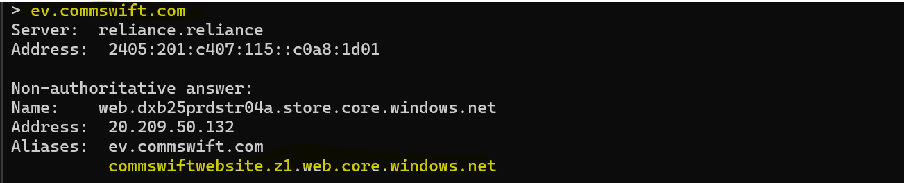

    In your setup, I noticed that your custom domain is currently mapped to a storage account where the custom domain is not registered.
    If you cannot see the custom domain option listed under networking settings, it means you enabled the hierarchical namespace feature when creating the storage account.

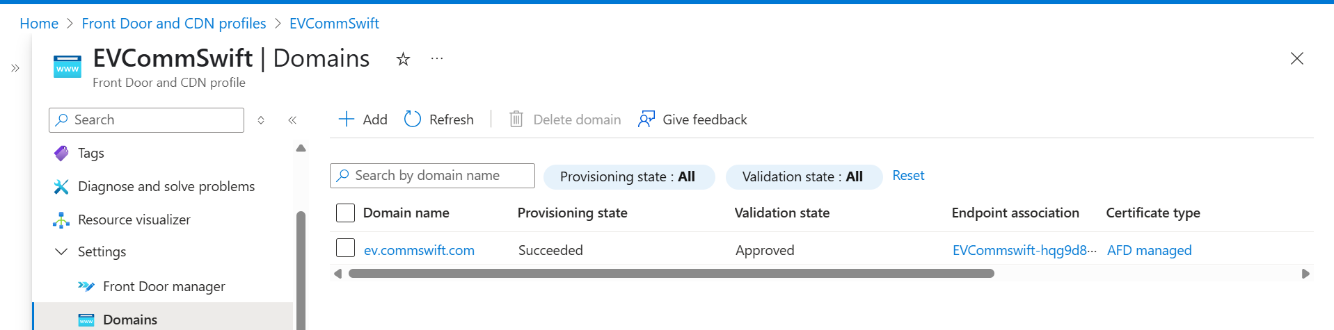

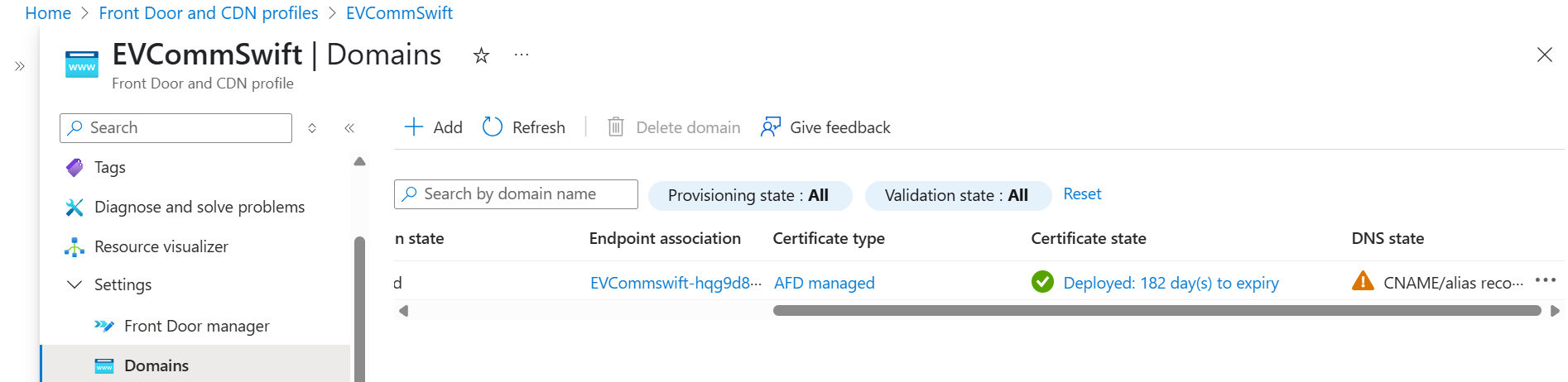

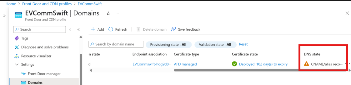

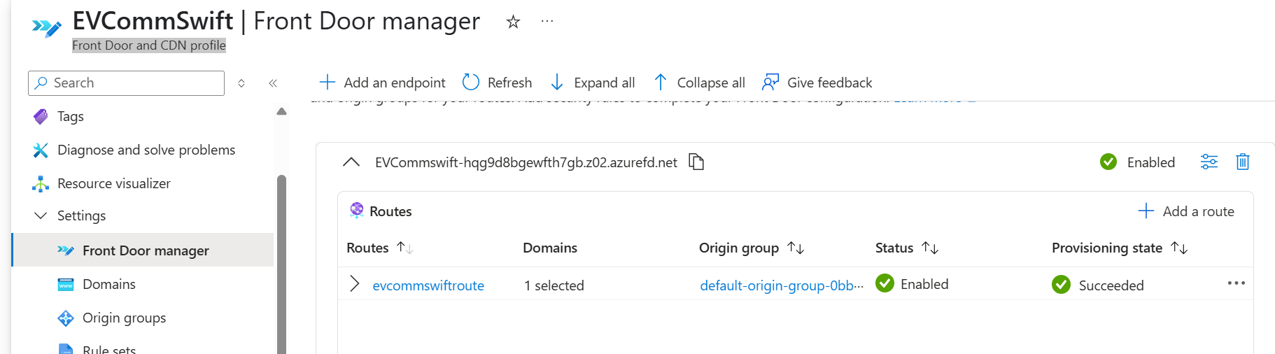

    From your screenshot, I can see that you have already added the custom domain and enabled SSL on Azure Front door using the AFD managed certificate. However, the CNAME record was not mapped to the Azure Front Door endpoint.User's image Also, ensure that the origin settings are correctly configured for the storage account.
    • In the route settings: - Forwarding and Accepting protocols should be set to HTTPS
    • Finally, map the custom domain to the AFD endpoint by creating a CNAME Record.
        ev.commswift.com   CNAME    EVCommswift-hqg9d8bgewfth7gb.z02.azurefd.net

      Domain Status: Your Front Door endpoint (EVCommswift-hog9d8bgewfth7gbz02.azurefd.net) appears active.
        The certificate is deployed (182 days to expiry), but the DNS state needs confirmation—ensure the CNAME for your custom domain points to this endpoint.
