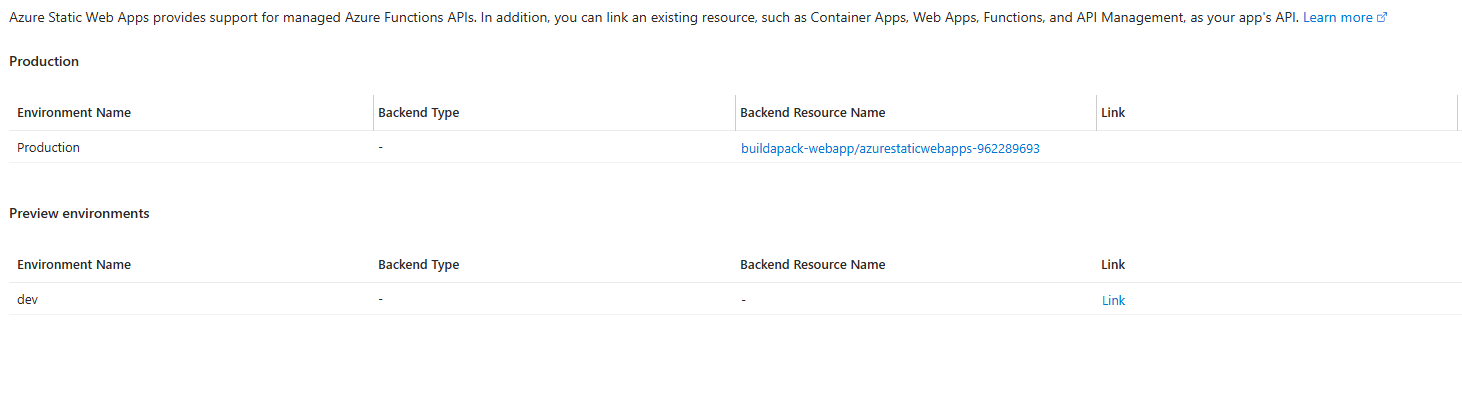

Kyle 20 Reputation points
2025-05-03T14:12:55.96+00:00
Uploaded image

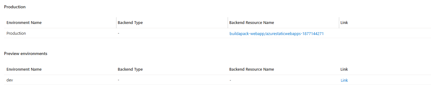

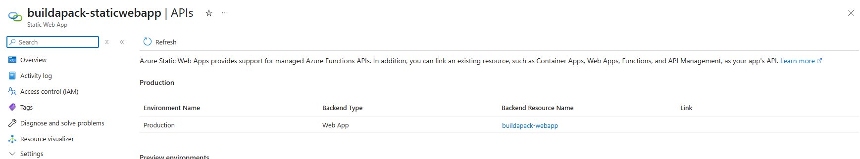

I have tried multiple times now to add a linked backend to my next.js app in azure static web apps. I allow the static web app to create the new web app & app service. The operation goes through successfully. For a brief period of time I will see 'Web App' under Backend Type and the correct resource under Backend Resource Name, but then it quickly reverts to what you see here.
The backend does not function and I cannot hit a healthcheck api endpoint on the web app resource directly, from a curl request, from my next.js app, or any other way I have tried. I then have to unlink the backend and wait for 30-60 minutes for something in the cache to clear to reset my website back to working.
At this point I've exhausted everything I believe I can try on my end. I'd really like to get a linked backend web app of S1 tier setup.

    It seems the issue is caused by a misconfiguration in linking external backends for Next.js apps in Azure Static Web Apps. In the second image, the Backend Type is missing, and the Backend Resource Name is incorrectly formatted, which is likely causing the problem.
