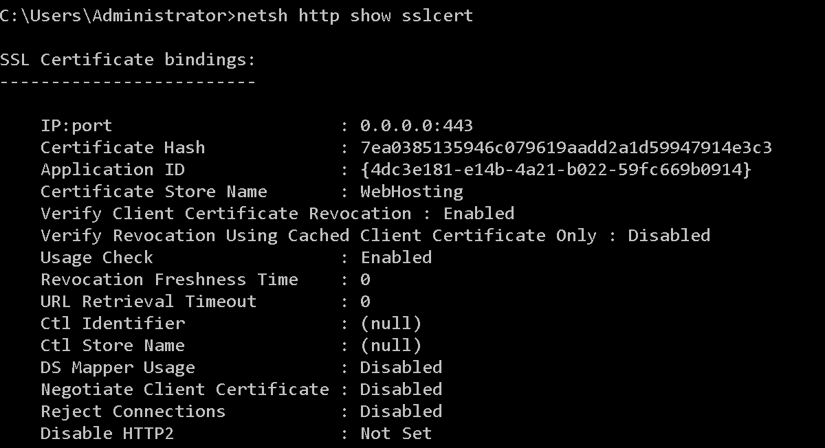

      • Use the following command to view bindings:
            netsh http show sslcert
      • To re-bind:
            netsh http add sslcert ipport=0.0.0.0:443 certhash=THUMBPRINT appid={APP-ID}
