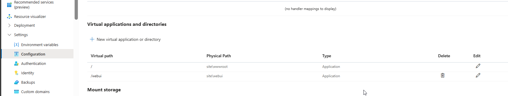

  • For frontend, mapped the configuration path in azure app service i.e., site/webui - this folder structure will come in kudu console.

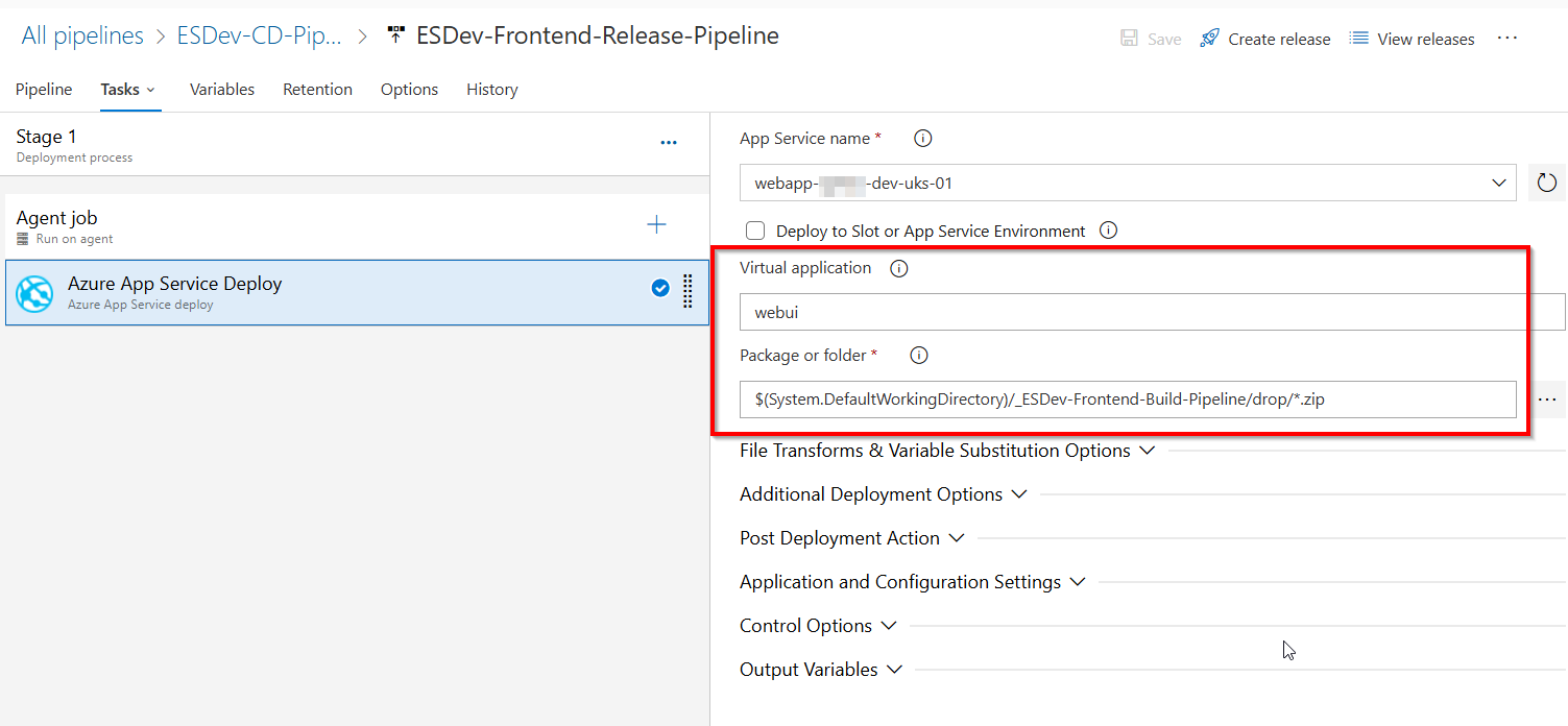

Backend deployed successfully. In the Frontend release pipeline, configured like below
enter image description here

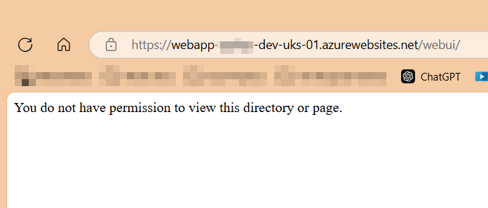

the deployment is successful and If i access the site like: https://webapp-stick-dev-uks-01.azurewebsites.net/webui/
Unable to understand what will be the root cause of the issue, where I'm missing anything to configure.

    First, verify that the virtual application is properly configured in Azure App Service Path Mappings, ensuring /webui points to site/webui. Next, check if your React build has the correct homepage setting in package.json ("homepage": "/webui") and that React Router (if used) includes the basename="/webui" prop.

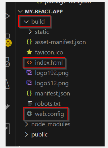

    • Once you build the app using npm run build, a build folder with static assets is created.
    • Create a web.config file in build folder and add the below settings to serve the virtual app route.

    • Deploy only the contents of the build folder into the webui folder.
    • Based on our discussion, I noticed that you are deploying the complete folder including build, Src directories and default file is missing in your case.

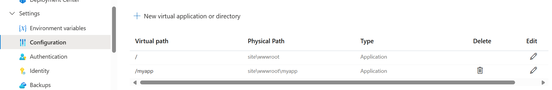

    • Set the physical path of /webui to site\wwwroot\webui in Virtual applications and Directories (myapp in my case).

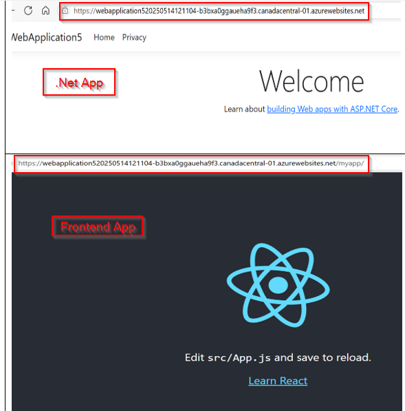

    {6E941205-CBBF-4D74-9BFF-594FE750C022}
    Output:
