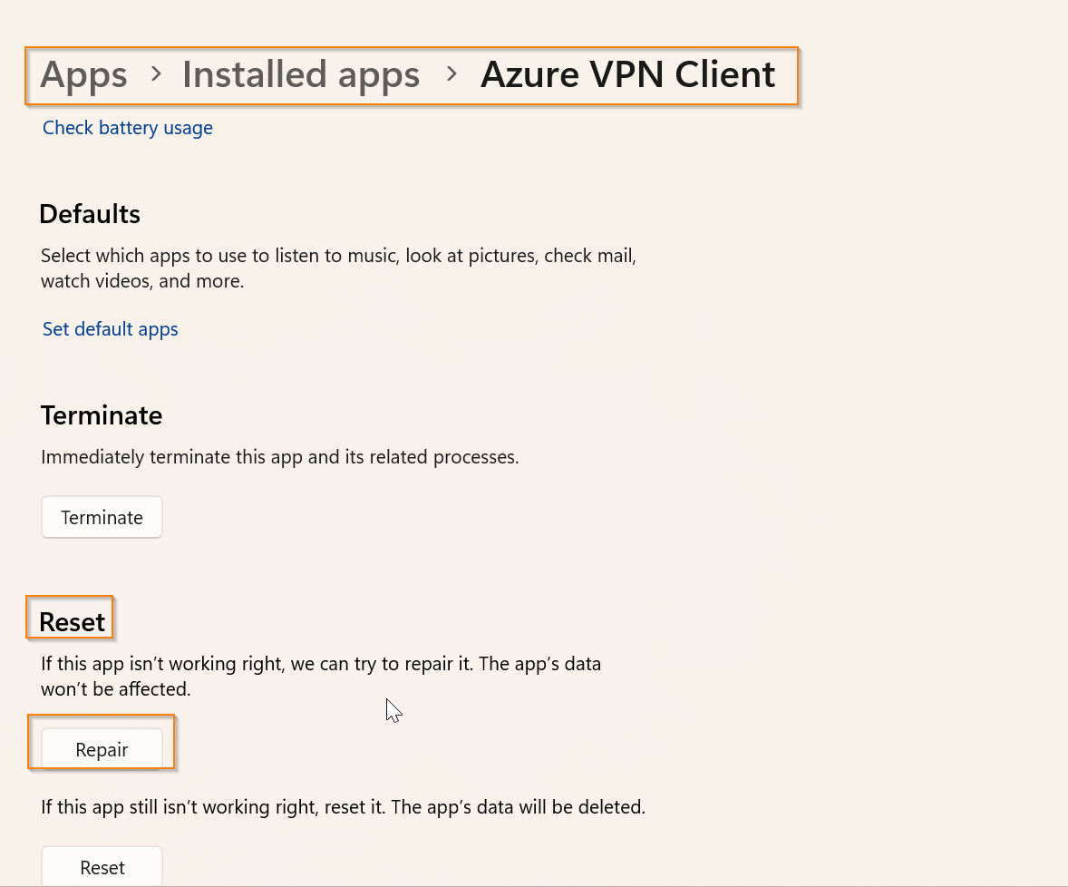

    To resolve the issue: Go to Settings > Apps > Installed Apps > Scroll down and find Azure VPN Client, then click **Advanced options >**Under the Reset section, click the Repair button.

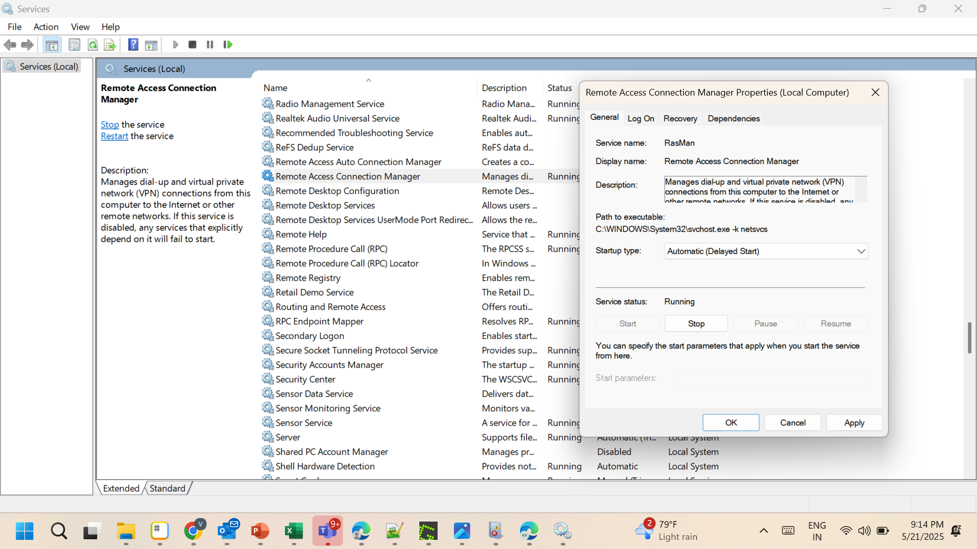

    Restart the 'rasman' (Remote Access Connection Manager) service and set its startup type to 'Automatic'

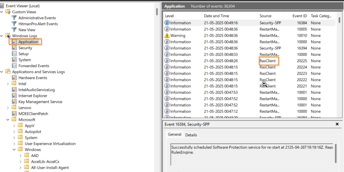

    If you are still facing the same issue, kindly navigate to Event Viewer and expand Windows Logs > Application. Search for Event ID 1460 — this entry will display the reason for the issue.

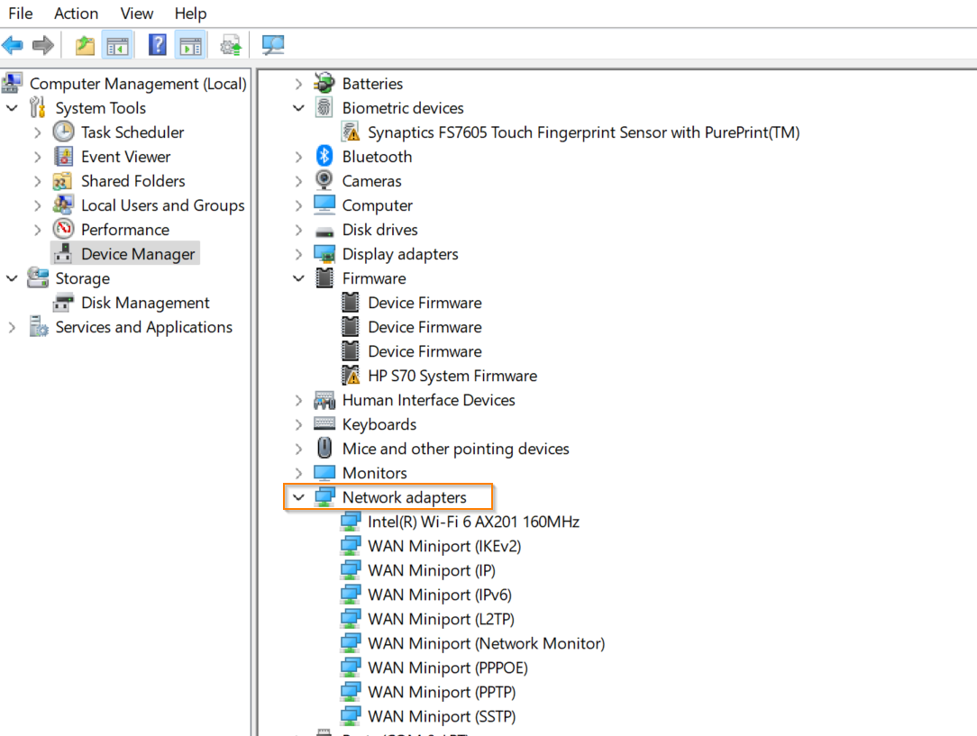

    • Delete/Uninstall all WAN miniport network adapters from Device manager, and then click on Action > Scan for hardware changes or perform a machine restart.
    enter image description here
