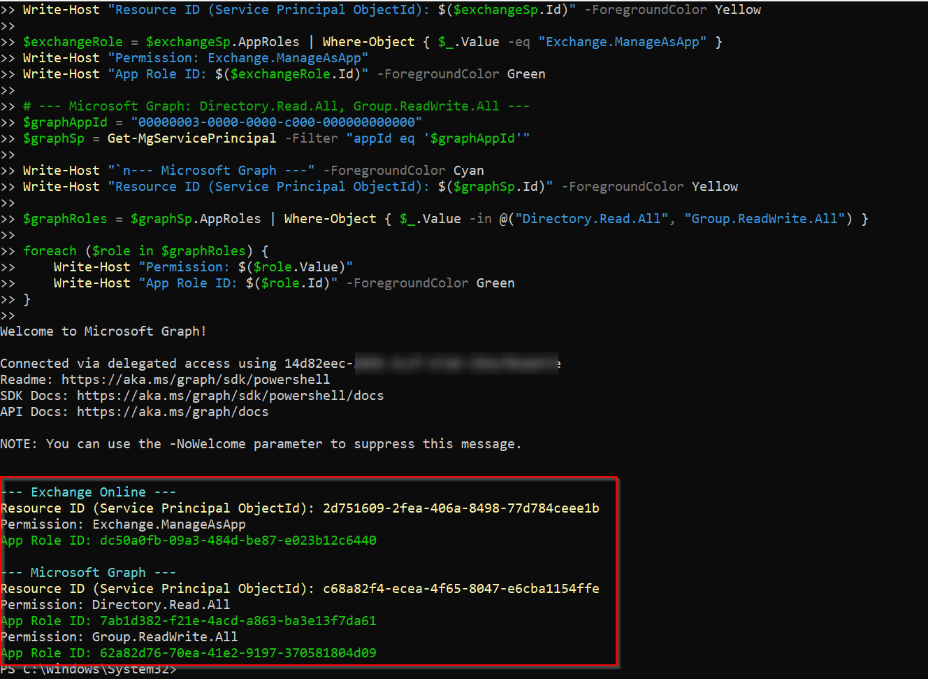

    Hence to resolve the issue, assign API permissions like below:

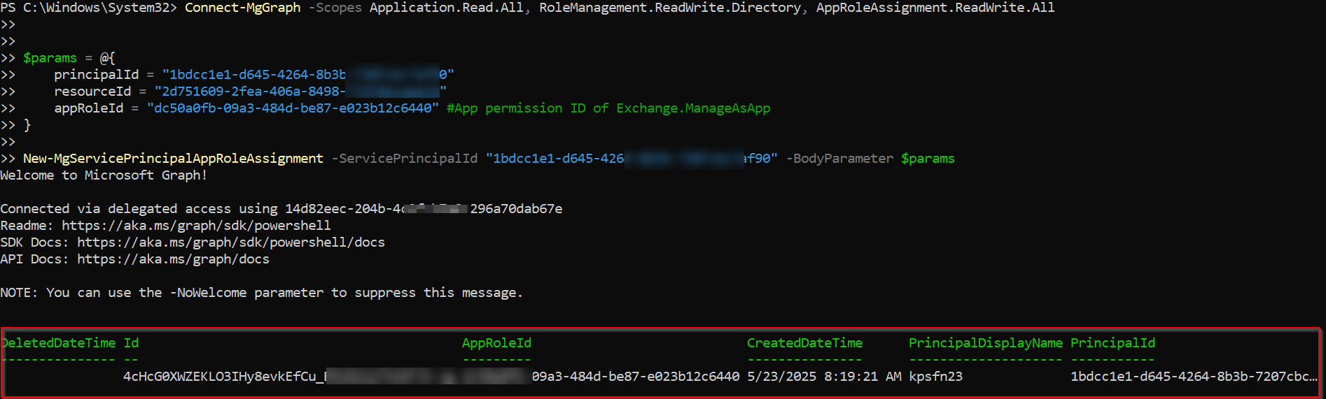

    Connect-MgGraph -Scopes Application.Read.All, RoleManagement.ReadWrite.Directory, AppRoleAssignment.ReadWrite.All
    $params = @{
    	principalId = "ObjectIDofMSI"
    	resourceId = "2d751609-2fea-406a-8498-xxxx" ##ObjectId of Office 365 Exchange Online Enterprise application
    	appRoleId = "dc50a0fb-09a3-484d-be87-xxxx" #App permission ID of Exchange.ManageAsApp
    New-MgServicePrincipalAppRoleAssignment -ServicePrincipalId "ObjectIDofMSI" -BodyParameter $params

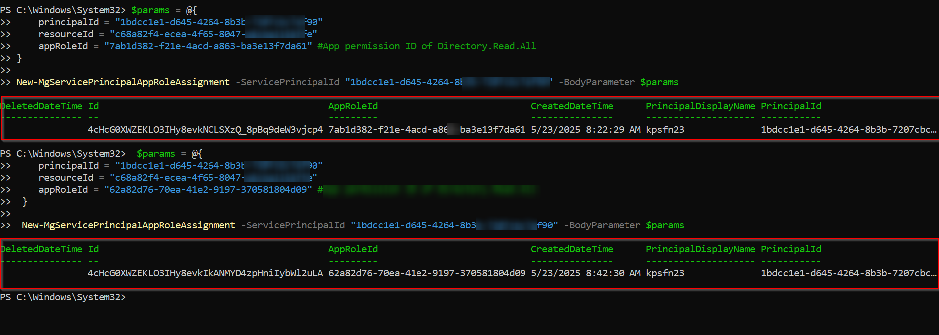

    Assign Microsoft Graph API permissions:
    $params = @{
    	resourceId = "c68a82f4-ecea-xxxx" #ObjectId of Microsoft Graph Enterprise application
    	appRoleId = "7ab1d382-f21e-4acd-a863-ba3e13f7da61" #App permission ID of Directory.Read.All
    $params = @{
    	appRoleId = "62a82d76-70ea-41e2-9197-370581804d09" #App permission ID of Group.ReadWrite.All

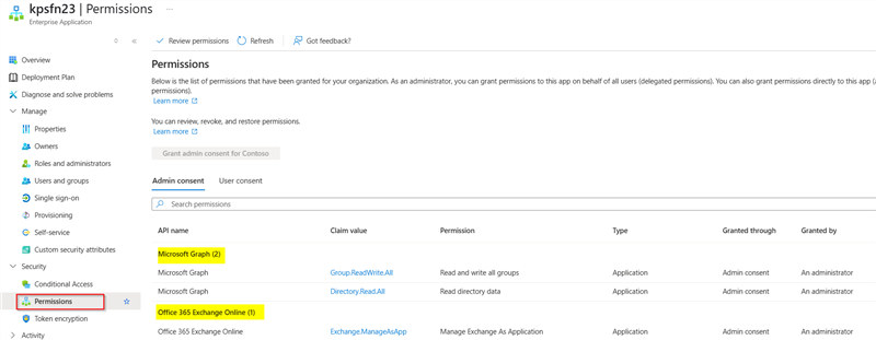

    The permissions will be assigned to the managed identity successfully:
    Go to Enterprise applications and search for your identity:

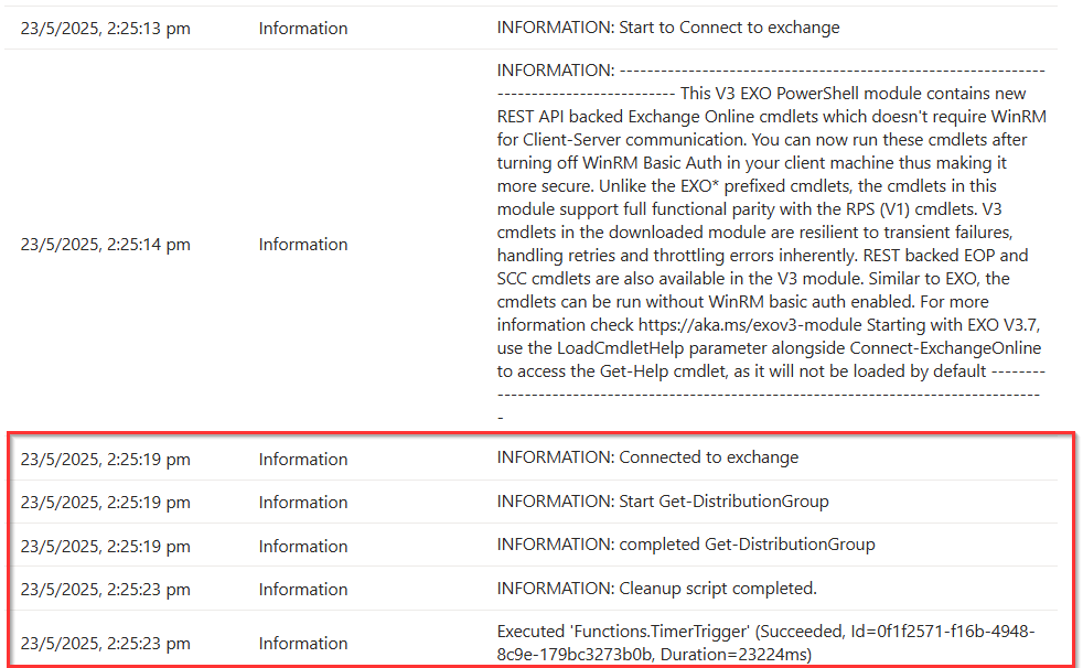

    I assigned Exchange Admin role to the Function App's managed identity:
    OUTPUT:

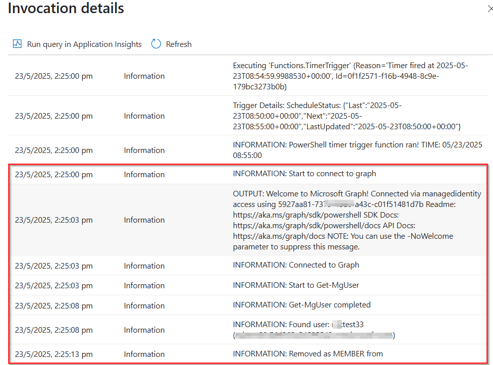

    Connected to Microsoft Graph:
    Connected to Exchange:image
