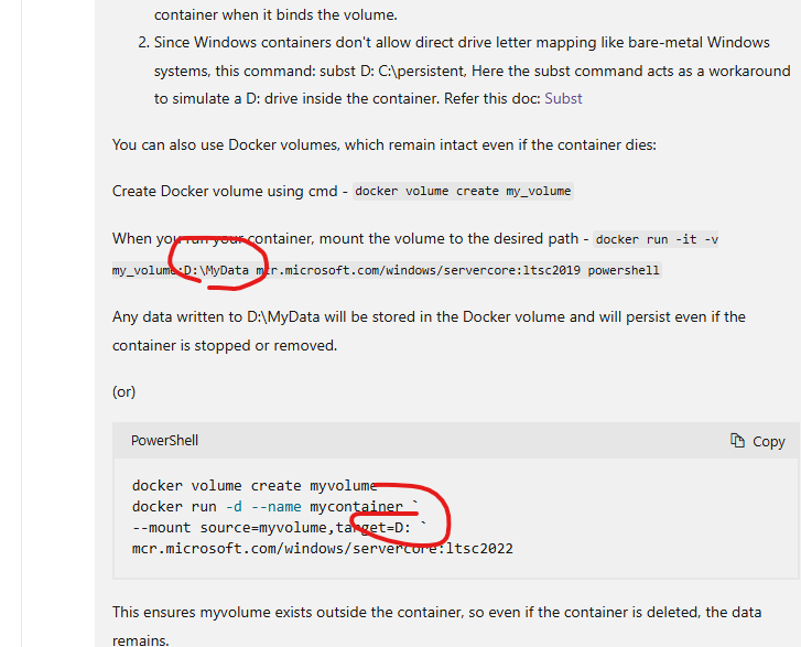

    Creating a D drive inside a Windows container agent in Azure DevOps isn't straightforward because containers usually operate with a single root filesystem (C:). However, you can achieve similar functionality using volume mounts or virtual drives.
    Here are some methods:
    1. You can mount an additional volume to simulate a D: drive:
         docker run -v D:\data:C:\mnt --name my-agent windows-container-image
      This maps D:\data from the host to C:\mnt inside the container.
    2. Or you can create a virtual drive inside the container using subst: This makes C:\mnt appear as D: inside the container.
         subst D: C:\mnt
    Hope this helps!
    Please Let me know if you have any queries.

  1. Shyam Kumar 846 Reputation points
    2025-05-27T11:12:54.1233333+00:00
    HI Durga,
    1.
    Document you have given is not opening, please share me the working link
    2.
    Below highlighted indicates container path right ?

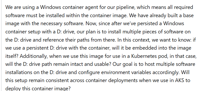

  2. Durga Reshma Malthi 4,430 Reputation points Microsoft External Staff Moderator
    2025-05-28T08:36:32.6066667+00:00
    Hi Diptesh Kumar
    As per discussion in private message,
    Let me Clarify each one of your questions:
    Will software on D: be embedded into the image?
    1. No, the D: drive itself will not be embedded into the container image. If you're mounting D: as a volume (-v D:\agentdata:C:\persistent), the software installed on D: will reside on the host, not inside the container image.
    Will D: remain intact and usable when the image is deployed in Kubernetes (AKS)?
    1. Not automatically. Kubernetes doesn’t know about subst or drive letters
    2. When deploying to AKS, the container image itself will be immutable. Since D: is being mapped dynamically, it won't exist inside the Kubernetes pod unless explicitly configured. You will need to use persistent storage like PVC's - Persistent Volume Claims.
    Can this setup remain consistent across AKS deployments?
    1. Yes, but only if you use a Persistent Volume (PV).
    If the goal is to keep software installed on D: store it in an Azure Files share.
    For this Go to Azure Portal -> Create an Azure Storage Account -> Then Navigate to File Shares and Create it. Now, you’ll map D: inside your Windows container using the SMB protocol.
    Inside Storage Account, go to Access Keys and copy the key and then go to your File Share and Connect via SMB. Copy the provided net use command.
    Now Inside the Windows container, run:
    net use D: \\mywindowsagentstorage.file.core.windows.net\persistent-agent-share /user:mywindowsagentstorage xxxxxxxxxxxx==
    This mounts D: inside the container and persists software installed there.
    In AKS, ensure the drive remains consistent. Define PersistentVolume
    apiVersion: v1
    kind: PersistentVolume
    metadata:
    spec:
      capacity:
        storage: 100Gi
      accessModes:
        - ReadWriteMany
      azureFile:
        secretName: azure-secret
        shareName: persistent-agent-share
        storageAccountName: mywindowsagentstorage #your storage account name
    In your Kubernetes manifest, Create PVC:
    apiVersion: v1
    kind: PersistentVolumeClaim
    metadata:
    spec:
      accessModes:
        - ReadWriteMany
      resources:
        requests:
          storage: 100Gi
      volumeName: azure-file-pv
    Mount it inside the pod:
    containers:
      - name: windows-agent-container
        image: my-agent-image
        volumeMounts:
          - name: azure-storage
            mountPath: /persistent
    volumes:
        persistentVolumeClaim:
          claimName: azure-file-pvc
    Inside the container, run: subst D: C:\persistent
    This ensures D: drive remains accessible.
    Another approach you can try to use an init container in Kubernetes to restore the D: drive mapping before the main workload runs.
    Hope this helps!
