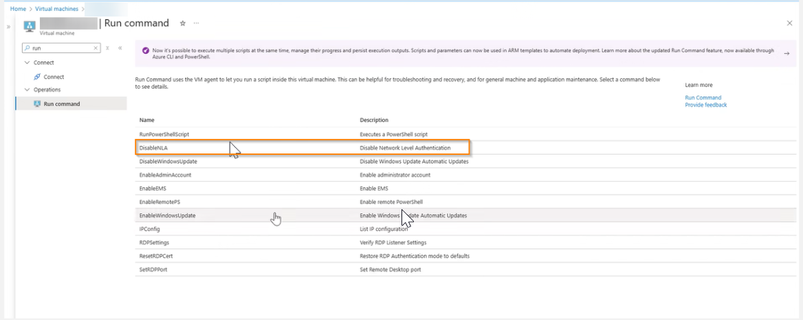

    5. Please check by disabling NTLM Fallback, since some users have resolved authentication issues by adding a registry key to disable NTLM fallback. Disable the NTLM by navigating to your VM > Run command > DisableNLA User's image

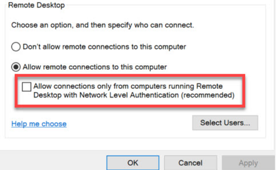

    Lastly, please log in to the VM with a local user account, navigate to the system in the Control Panel, select Remote Settings, and uncheck "Allow connections only from computers running Remote Desktop with Network Level Authentication (recommended)" as shown in the screenshot below. This should be disabled if you are connecting from an unregistered device.
