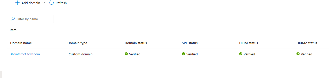

    UPDATE: Corey determined that Domain, SPF, DKIM, and DKIM2 needed to be showing as Verified for domain to be able to be selected. I added that check as #1 below.

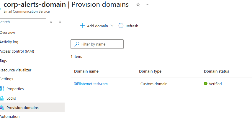

    1. Please make sure your email domain is showing Verified for Domain, SPF, DKIM, and DKIM2. You may do this by navigating to your Email Communication Service -- Settings -- Provision domains blade and making sure that all four columns show as Verified, similar to below:
