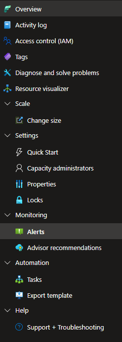

In the diagnostic settings of my Azure Microsoft Fabric Capacity, I currently only see logging options for:
  • Administrative
  • Security
  • ServiceHealth
  • Alert
  • Recommendation
  • Policy
  • Autoscale
  • ResourceHealth
However, I need to add capacity-specific metrics that track the capacity workload, such as:
  • CapacityMetrics
  • WarehouseQueryLogs
  • ActivityLogs
  • PipelineRuns
How do I configure my capacity such that I can add these diagnostic settings?

  1. NavinChristen 0 Reputation points
    2025-07-21T07:48:21.6366667+00:00
    Hi @Sampath ,
    Your below comment is misleading, as we cannot find such an option in Fabric Capacity.
    Could this be a preview feature and not GA?
    Navigate to Diagnostic Settings
    • Open Azure PortalMicrosoft Fabric Capacity.
    • Go to MonitoringDiagnostic Settings.
  2. Hao Vo Van 0 Reputation points
    2025-11-29T03:32:57.2766667+00:00
    The resource type Microsoft.Fabric/capacities not yet support for diagnostic settings so far. I have tried to run the Azure CLI command as below:
    # Define variables
    RESOURCE_GROUP_NAME="<YourResourceGroupName>"
    RESOURCE_NAME="<YourResourceName>" # e.g., your Fabric capacity name or Data Factory name
    RESOURCE_PROVIDER="<ResourceProviderNamespace>" # e.g., Microsoft.Fabric/capacities or Microsoft.DataFactory/factories
    SUBSCRIPTION_ID="<YourSubscriptionID>"
    WORKSPACE_NAME="<YourLogAnalyticsWorkspaceName>"
    DIAG_SETTING_NAME="CapacityMetricsToLA"
    # Construct full Azure resource IDs
    RESOURCE_ID="/subscriptions/$SUBSCRIPTION_ID/resourceGroups/$RESOURCE_GROUP_NAME/providers/$RESOURCE_PROVIDER/$RESOURCE_NAME"
    WORKSPACE_ID=$(az monitor log-analytics workspace show --resource-group <YourWorkspaceRG> --workspace-name $WORKSPACE_NAME --query id --output tsv)
    # Create the diagnostic setting to send AllMetrics to the Log Analytics workspace
    az monitor diagnostic-settings create \
        --name $DIAG_SETTING_NAME \
        --resource $RESOURCE_ID \
        --workspace $WORKSPACE_ID \
        --metrics "[{category:AllMetrics,enabled:true,retention-policy:{enabled:false,days:0}}]"
    then got an exception: (ResourceTypeNotSupported) The resource type 'microsoft.fabric/capacities' does not support diagnostic settings.
    I have to change the solution to extract data from semantic model of Microsoft Fabric Capacity Metrics App via PowerBI REST API to ingest data into Azure Log Analytics Workspace.
