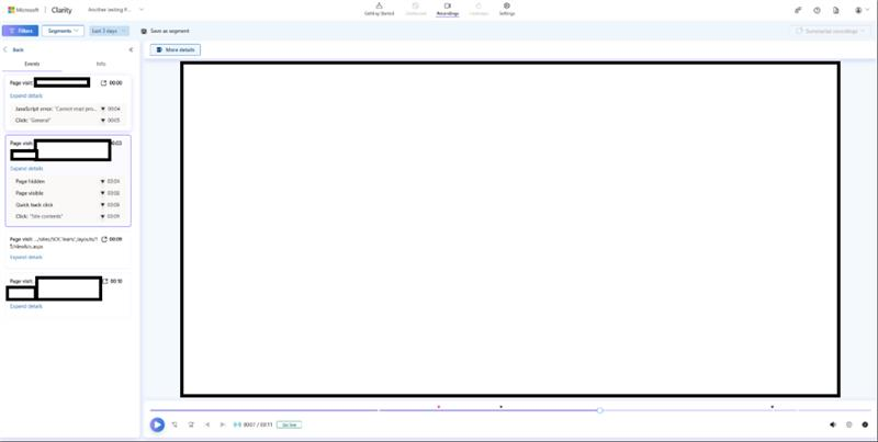

This has been running for several days now. I have been visiting myself to add data to it, but no data is being pulled.

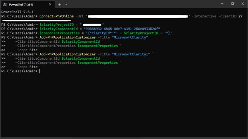

    You can follow these steps to configure it:
    You should run this command first to connect Pnp in PowerShell
    Connect-PnPOnline -Url " You input your specific SharePoint site URL here " -Interactive
    Set your variables $clarityProjectID = "YOUR_CLARITY_PROJECT_ID_HERE" -> You get from project Id in Clarity $clarityComponentId = "9088b932-6b45-4dc7-a391-256c4933526f" -> this one is a static Clarity ID so you dont need to change it. It can also use for another Sharepoint site.
     $componentProperties = '{"clarityId":"' + $clarityProjectID + '"}'
    Run the command to activate Clarity on the connected site Add-PnPApplicationCustomizer -Title "MicrosoftClarity"       -ClientSideComponentId $clarityComponentId       -ClientSideComponentProperties $componentProperties `      -Scope Site    Here is my example:
    undefined
    Noted: You should use PowerShell 7.5 for a more effective configuration. What's New in PowerShell 7.5 - PowerShell | Microsoft Learn

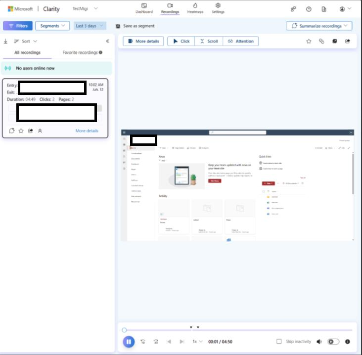

    Here is my result after adding it in Clarity app (You should wait around 15-30 minutes for it activate):
    undefined
