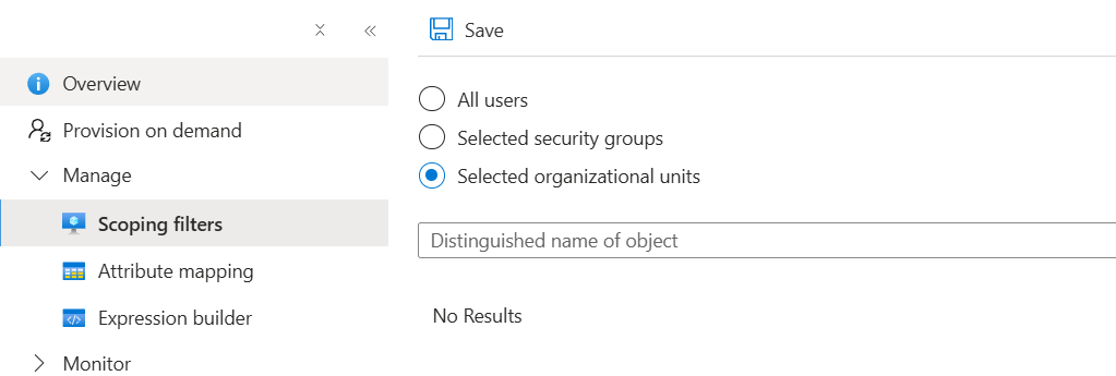

Scope Configuration: During the Azure configuration, do I only need to define the scope for the users I intend to provision?

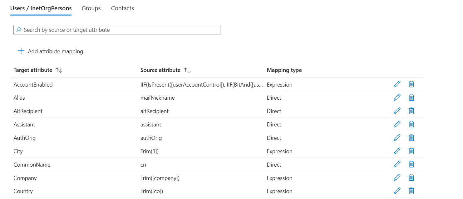

  1. Attribute Mapping: For attribute mapping, I have to plan to include only the attributes required for provisioning users into AD via the API-driven application. Is this approach correct? I should remove all other attribute which I am not provisioning for a AD user

    Scoping How to define which users are included
    In the Azure Portal during the API-driven provisioning configuration:
    Navigate to Scoping filters or **Target object scope
    You have three options
    All users – all users from the inbound system will be provisioned.
    Selected security groups – only users in those AAD groups will be provisioned.
    Selected organizational units (OUs) – only users in those AD OUs will be targeted for provisioning.
    Refernce: https://learn.microsoft.com/en-us/entra/identity/hybrid/cloud-sync/how-to-configure#scope-provisioning-to-specific-users-and-groups
    For Attribute Mapping
    Only map the attributes that your API-driven provisioning app needs for creating users in Active Directory.
    Unused or irrelevant mappings can and should be removed to keep the config clean and reduce sync complexity.
    For Attribute Mapping Best practices
    Go to Attribute mapping under your provisioning app.
    You can delete unnecessary mappings by clicking “Delete” on attributes you don’t need.
    Add only the attributes you need for AD user creation such as:
    givenName, sn ,userPrincipalName,mail,employeeId (if needed), manager
    Reference: https://learn.microsoft.com/en-us/entra/identity/hybrid/cloud-sync/how-to-configure#attribute-mapping
    https://learn.microsoft.com/en-us/entra/identity/app-provisioning/customize-application-attributes
