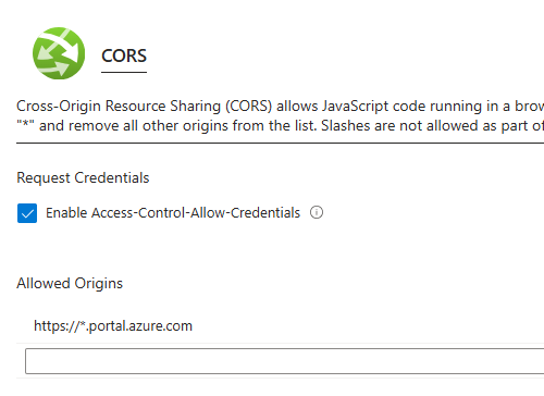

    You've correctly identified CORS as the central issue affecting your Azure Workbooks' ability to call a custom endpoint.
    Even if the origin is allowed, failure to set correct Access-Control-Allow-Headers, Access-Control-Allow-Methods, and Access-Control-Allow-Credentials will cause silent failures in Workbooks.
    Function App: Use the following CORS settings in your Azure Function App:
    • Allowed Origins: https://portal.azure.com (avoid wildcard subdomain if credentials are used)
    • Credentials Enabled done
    • Allowed Headers: Content-Type, Authorization, x-ms-client-request-id, x-ms-user-agent
    • Allowed Methods: GET, POST, etc. depending on your scenario
    Refer:
    https://learn.microsoft.com/en-us/azure/azure-functions/functions-how-to-use-azure-function-app-settings?tabs=azure-portal%2Cto-premium#cors
    You've already noted this, but to emphasize: Azure Function Apps and APIM must use an exact match for the Azure portal origin — https://portal.azure.com. Using https://*.portal.azure.com will be rejected if Access-Control-Allow-Credentials is true, per the CORS specification.
    Refer:
    https://developer.mozilla.org/en-US/docs/Web/HTTP/Guides/CORS#credentialed_requests_and_wildcards

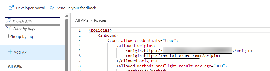

    If you’re using multiple APIs behind your APIM instance, define the CORS policy at the All APIs scope to avoid missing origins on individual APIs.
    <inbound>
      <base />
      <cors allow-credentials="true">
        <allowed-origins>
          <origin>https://portal.azure.com</origin>
        </allowed-origins>
        <allowed-methods>
          <method>GET</method>
          <method>POST</method>
        </allowed-methods>
        <allowed-headers>
          <header>*</header>
        </allowed-headers>
      </cors>
    </inbound>
    Refer:
    https://learn.microsoft.com/en-us/azure/api-management/api-management-policies#access-restriction-policies
