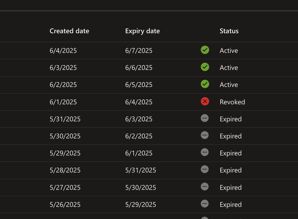

We have a CI pipeline that uses signtool with Azure Trusted Signing to sign binaries and it just randomly broke last week. None of the configurations were changed and it suddenly randomly decided to fail with a 403 error.
Maybe related: https://learn.microsoft.com/en-us/answers/questions/2282310/how-to-troubeshoot-403-error-when-using-trusted-si
We have already reverified that the required variables are correct and present (again, the pipeline just randomly broke with no changes in Azure or on the pipeline end).

Submitting digest for signing...
Unhandled managed exception
Azure.RequestFailedException: Service request failed.
Status: 403 (Forbidden)
Headers:
Date: Tue, 10 Jun 2025 10:20:17 GMT
Connection: keep-alive
Strict-Transport-Security: REDACTED
x-azure-ref: REDACTED
X-Cache: REDACTED
Content-Length: 0
   at Azure.CodeSigning.CertificateProfileRestClient.SignAsync(String codeSigningAccountName, String certificateProfileName, SignRequest body, String xCorrelationId, String clientVersion, CancellationToken cancellationToken)
   at Azure.CodeSigning.CertificateProfileClient.StartSignAsync(String codeSigningAccountName, String certificateProfileName, SignRequest body, String xCorrelationId, String clientVersion, CancellationToken cancellationToken)
   at Azure.CodeSigning.Dlib.Core.DigestSigner.SignAsync(UInt32 algorithm, Byte[] digest, SafeFileHandle safeFileHandle, CancellationToken cancellationToken)
   at Azure.CodeSigning.Dlib.Core.DigestSigner.Sign(UInt32 algorithm, Byte[] digest, SafeFileHandle safeFileHandle)
   at AuthenticodeDigestSignExWithFileHandleManaged(_CRYPTOAPI_BLOB* pMetadataBlob, UInt32 digestAlgId, Byte* pbToBeSignedDigest, UInt32 cbToBeSignedDigest, Void* hFile, _CRYPTOAPI_BLOB* pSignedDigest, _CERT_CONTEXT** ppSignerCert, Void* hCertChainStore)
Error information: "Error: SignerSign() failed." (-2147467259/0x80004005)
SignTool Error: An unexpected internal error has occurred.
The application signing was not successful.

  1. Meha-MSFT 1,165 Reputation points Microsoft Employee Moderator
    2025-06-11T16:48:11.0833333+00:00
    https://learn.microsoft.com/en-us/azure/trusted-signing/faq#common-error-codes-and-mitigations
    Error code (-2147467259/0x80004005)If you use Service Principal + certificate based authentication, check your Environment Variables listed under the table for "Service principal with certificate".
