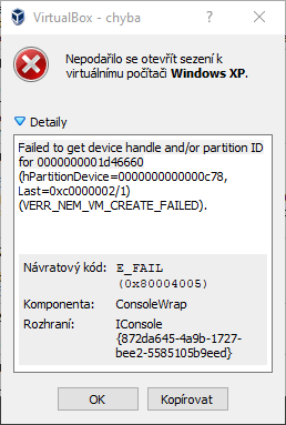

I wanted to install Windows XP in VirtualBox. I followed these instructions. I installed the program, created a virtual machine, but when running and selecting this installer, it crashes with an error.
Deleting and creating a Virtual machine or uninstalling and installing VirtualBox didn't help.

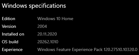

    Is this on a Windows Insider build?
    2020-12-01T06:36:08+00:00
    Again. Sorry. Mainly that I created a print screen and didn't put it here.
    And since I have Windows 10 Home, I can't use Hyper-V.

    Hi Michal,
    I did try out VirtualBox in one of my vm's. Started to setup an OS and ended up with a similar screen as you posted, although it was an empty vm. This program works quite differently from VMware. I could not easily see how to get the OS to actually install in VirtualBox. Perhaps running it in a vm itself could have been an issue (set this vm at 8GB ram, 2 cores).
    Have you tried running the Dism commands in an elevated command prompt for any window related issues:
    Dism /Online /Cleanup-Image /RestoreHealth
    sfc /scannow
